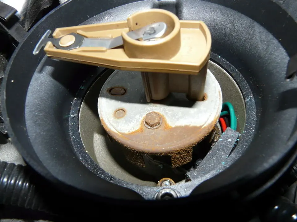

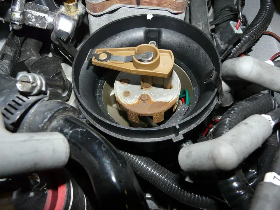

I was driving the car the other weekend (just had time to look at yesterday) and it felt like it was missing. So I remove the distributor cap and this is what I saw, plus the distributor cap contacts had a greenish colored buildup on them which you can see inside the distributor. The distributor is a rebuilt stock one from Napa. The distributor cap is made by Accel. I'm thinking of taking the distributor back but want to make sure it's not something else that's causing this issue. I will clean the contacts and see what happens.
What could be causing this buildup?
Thanks
Al

wells thats from water. the rust really got to the bolt and started to spread is what it looks like. the green is corrosion, like on a battery, but again probably from water. does the car sit up for extended periods of time?
If its water then its a mystery where it comes from because it doesn't get water under the hood.
Any yes the car does sit probably longer than its driven because its not my daily driver and if I have other things going on in my life it doesn't see much activity.
