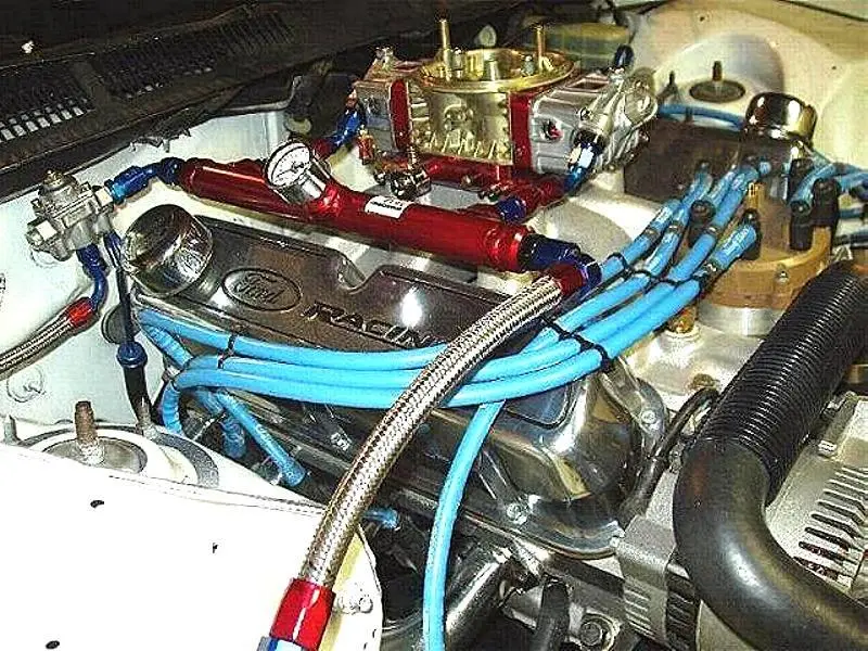

I would go with a Quickfuel carb. I LOVE mine.
Only had to set idle speed for the cam.
