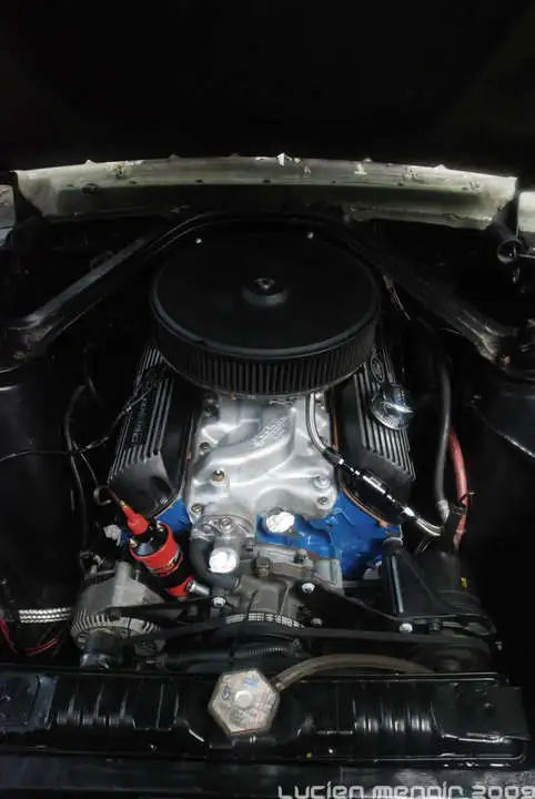

I guess you're going for original colors but have you thought of mixing it up and going for a non-original scheme? This is what I've done with mine:
