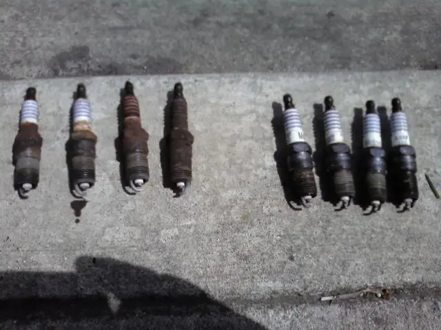

So, I pulled out my spark plugs and replaced them with motorcraft platinums (I had put in motorcraft copper plugs, last time). I find they have a white powder coat on the ends, and I am sure that means something specific. But what? Here they are after I took them out (cyl 4, 3, 2, 1, 5, 6, 7 8):

Anyway, help with info on what my white powder coated spark plugs might mean, or a link to a thread/article online that covers the subject, would be appreciated. I put the new ones in and my car runs great again, BTW. That was the issue with the intermittent hesitation and power loss I was having. :D
These are the basics to remember....
White means lean,Black is oil passing threw the rings,and getting burnt up,Wet is fuel,and Tan in color is a perfectly running engine.
What you have is is really not good,the good ol saying mean is lean is true,but it could cause you grief too,i would be getting your air/fuel checked out. ;)
How many miles have those plugs been in there. MOST ford plugs with higher mileage have a bit of white like yours, it's just the way they tune these things from the factory, I would not be concerned... In fact I am more concerned on what is leaking down the plug wells on the two plugs that the porcelain is BROWN...

I had the copper plugs in the pic in there for 8-10K miles, then started getting a P0301 (cyl 1 misfire) code.
I checked that out and saw a very corroded connection between the cyl 1 plug and it's COP. I swapped the COP with cyl 5, and the code came back to cyl 1 after I deleted the code w/ my reader.
I am curious about what specifically I should check for cyl 1&2 if it is oil vs coolant. Gaskets around I should check? Hoses? Not sure and would really appreciate the help.
I want to get the car Dyno'd again soon, and I'll do it with the A/F ratio to make sure things are going OK if that is a good idea, too.

You need to pull the valve covers and check the gaskets....have new OEM gaskets handy....I bet the problem is oil getting past those gaskets....
