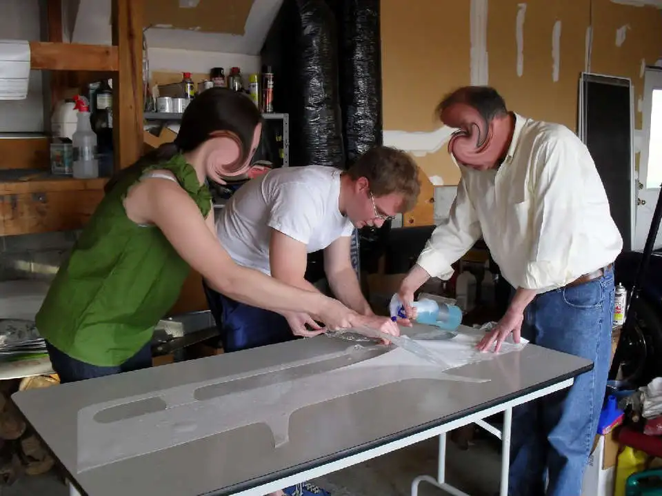

Anyway, I purchased a clear bra mask from clearmask.com. The mask is virtually invisible. I applied it myself and it was the first time I have attempted anything like it.
The mask protects from all rock chips. It is very resilient. It is perfectly clear and has not tinted (yellowing) in any way. It is easy to manage. You can wash/wax it like your normal paint. I probably would stick to hand application if performing any wax job.
For someone (me) who isn't experienced with this sort of thing had a somewhat difficult time applying the mask. I had the help of my dad and at the time, my girlfriend. The mask comes in one large piece. It is manufactured to be cut on the small side. The reason for this is the method to apply the mask is to fasten down the middle and stretch it outwards to the side to make it fit. If I were to do this again I would most definitely cut it up into three pieces from the get-go. During installation I had to cut it up because it was just not fitting right (which is because i am not an expert, not a fault of the design). It would have gone a lot more smoothly had I cut it up sooner.
I am under the impression that they are to last at least 5 years. How to get them off I really haven't looked in to it. I am sure its some sort of heat source.
Pictures...let me try to see if I have any. I know I have one from when I was in the process of installing it. You can see how the mask comes in this picture. The white is just a backing that the clear mask adheres to for protection and shipping purposes. As you can see I am removing the mask from that backing:
As I said before, it was a pain but I would certainly do it again. All of the highway driving I have put on the car has made it worthwhile many times over.

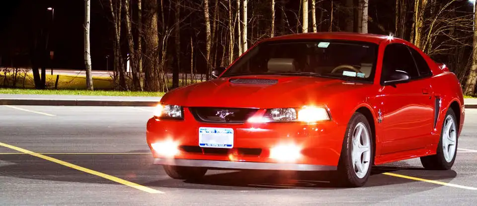

I dont have any super close up shots but I did find this one. This picture has the mask installed on the front bumper. This was taken with my crappy 28-135mm lens:
I have a 50mm prime now so when its a nice day ill go out and take a close up if youd like :nice:

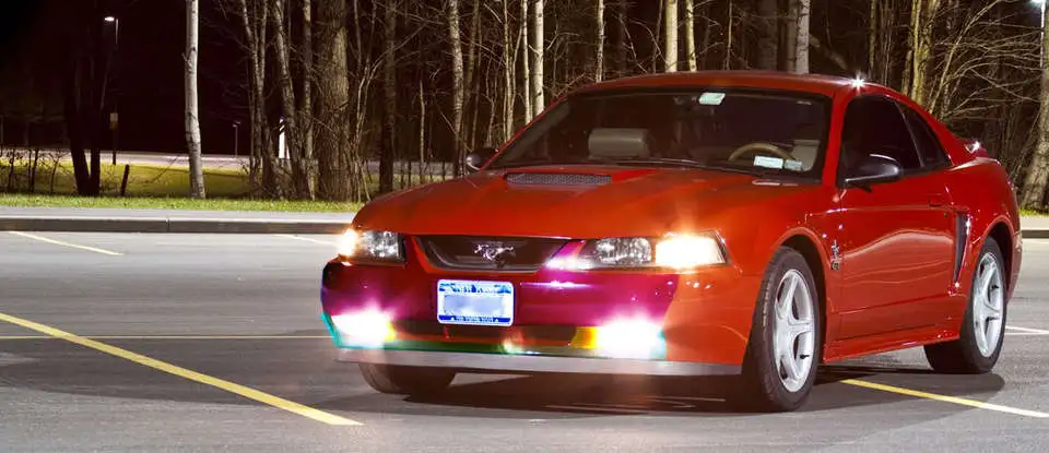

Heres a photoshop i did a while back depicting the different sections that I ended up cutting it into. Where the colors end are pretty much where the actual mask ends. it does not cover the entire bumper. it simply protects from head on debris:
Theres a top and bottom piece with 2 pieces that go in towards the fog lights.
