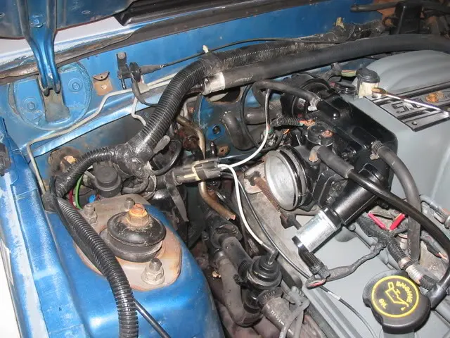

did mine in grey. then TB in gloss black ect.

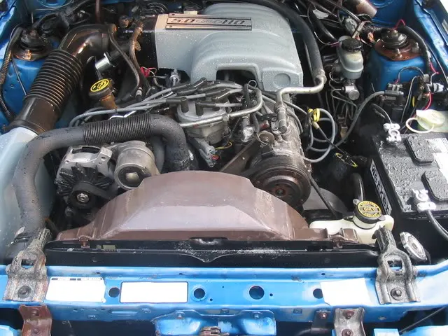

ryan* your engine looks like mine, not the worse in the world but sure needs it attention!!!and you 5.0 cover plate looks good! doubt i'll put that much detail into it!
as for silver, it looks like it would be a waste of time for me. Although it is in improvement it doesn't flare out. i think aluminum looks better IMO. but black does work also! Maybe a aluminum intake with aluminum valve covers, detail the lines black, and paint the 5.0 cover plate black and the tb and egr black! so i guess i should just take the egr apart from the intake and paint the tb,egr and other stuff all as one piece?
