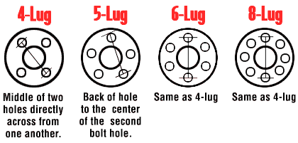

Measure from ceenter-to-center useing the hole to the left as #1, the next #2 and the next #3....measure from #1 to #3...CENTER-to-CENTER
You measure center to center on opposite lugs for 4, 6 and 8 lug wheels.
For five lugs you can measure center to far edge of a second lug.
Here is a site that gives the info you need to measure the bolt circle diameter:
https://www.rsracing.com/tech-wheel.html
