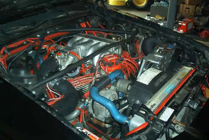

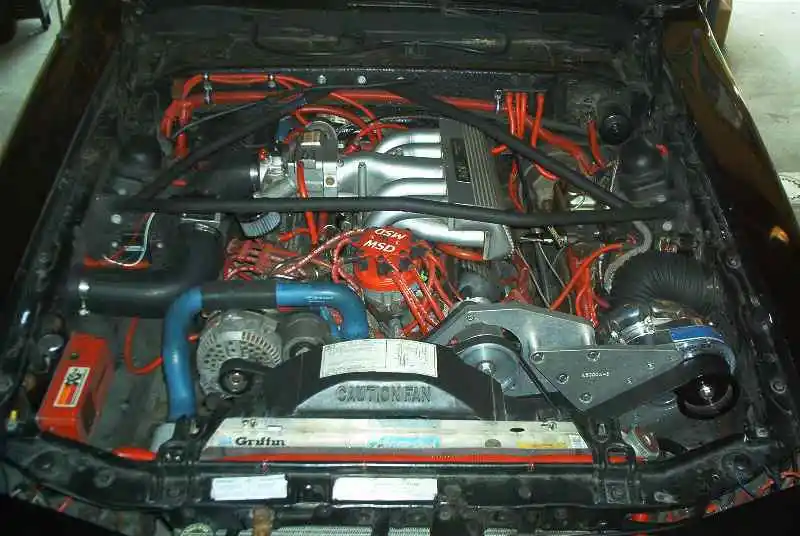

A couple pics of my most recent upgrade, the P1SC.....

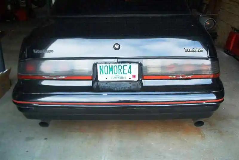

here is my 91 AKA THE PINK PANTHER. it's just a stock 5.0 HO with dual 50 series flows and all 3 cats are gone too. pretty fast cars stock for how big they look.

Nice looking v8 swap. Esp like the supercharger. Between me and the boys we've got 3 turbo t-birds, a shelby gt500, an SVO and 3 other stangs. Know where I can get a rt frt fender for an '88 turbo coupe?

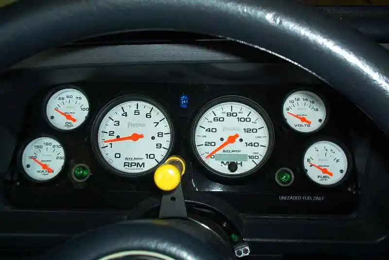

If the speedo is electric - how do you provide a signal for it? Will it read the signal from the standard t-5 VSS?
Yes the speedo is electric. And yes it will read from the factory T-5 sensor. It just counts the pulses for 2 miles and converts to MPH.. You actually put it into a calibrate mode, drive the car a measured 2 mile distance, then voila, done. Any gear/tire changes and you got an accurate speedo... :D No messing around with the little gear in the tranny, trying to get it close...
STeve
Mike-
I do get a little bounce when I am slowing to a stop with the speedo, but i think its just the ford sensor in the tranny. I replaced it once in the begining when I had the factory speedo because of the same problem. Other than that it work very nicely...

TallyMan said:
Mike-
While we're on the speedo subject, autometer sent me this reply when I asked about running an electric speedo in my lx:
Yes, our electronic programmable speedometers will work with your
application. However, you would need to run our Programmable Electric
Speedometer sender part #5292.
This is great news for me as my stock speedo and guages all suck and the tach and speedo make terrible noise so they got to go. :D
