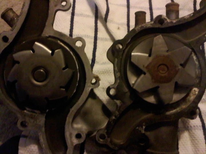

i had the water pump on the left installed and it seemed like I was not getting good waterflow through my cooling system. Do you think the diff. in the propeller could be the cause? The one on the right is what im used to them looking like.
yeah one on the right looks normal, what i just put on my cobra. the lip of the propeller on the left looks too sideways and not enough up and down to catch and sling the water
