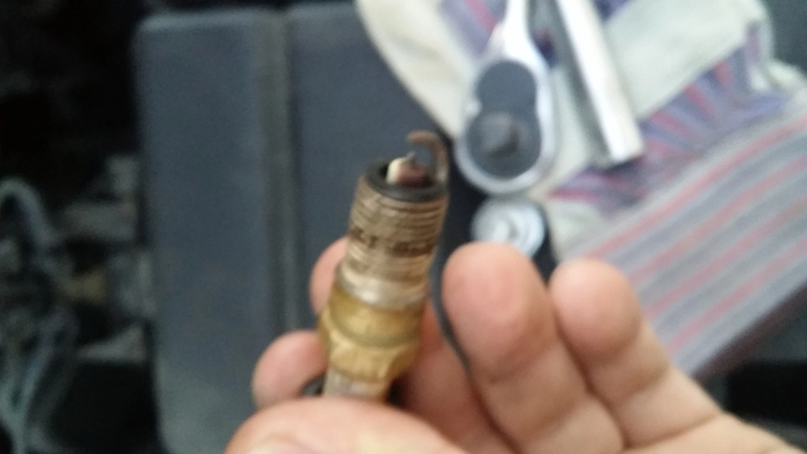

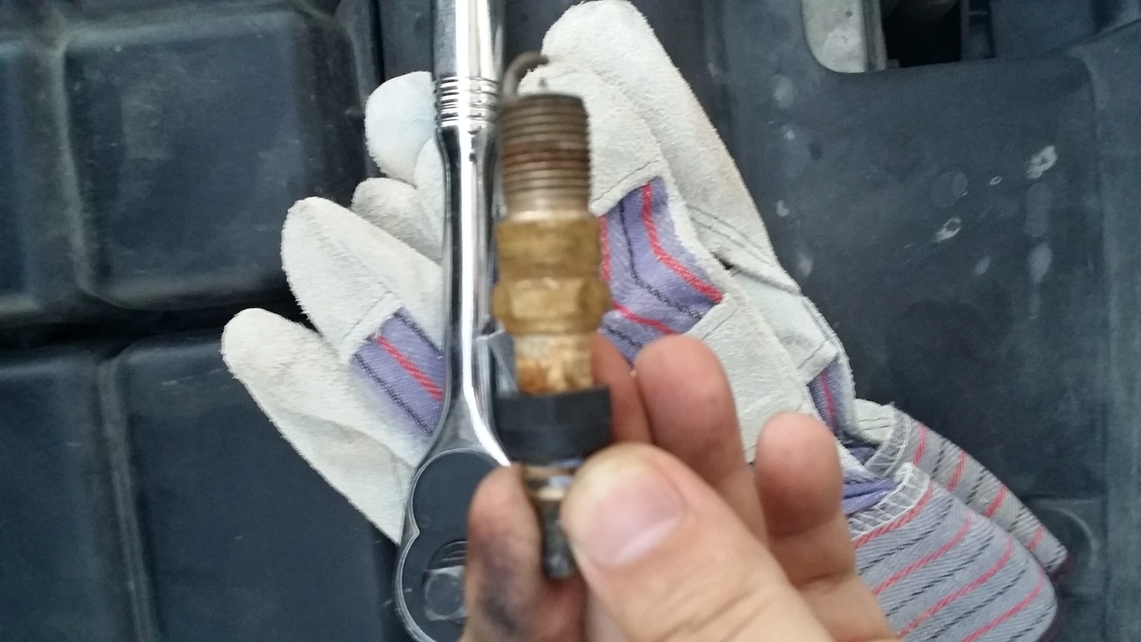

Well after it turned off again under the exact same conditions as mentioned above, a friend of mine told me to check the spark plus. I never checked them because the previous owner told me he had just replaced them and this is what I found. Sure hope this is the problem. What do you guys think?
