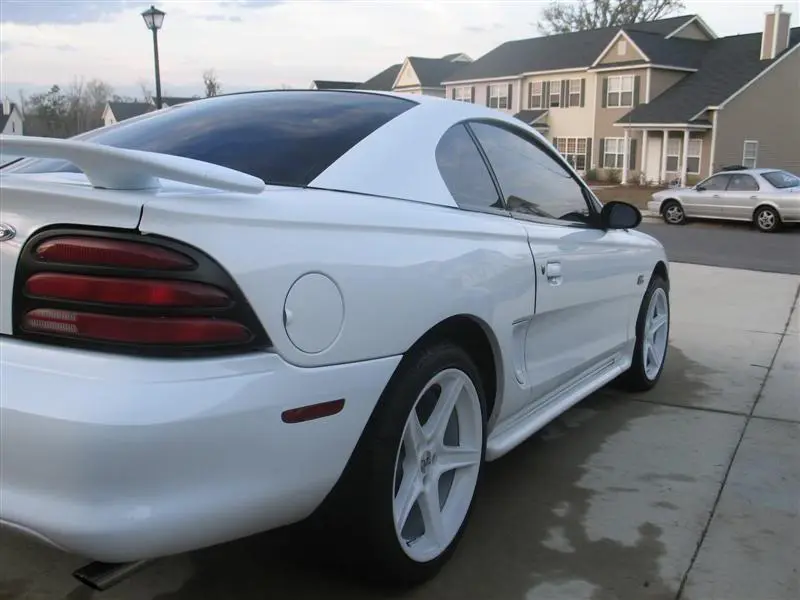

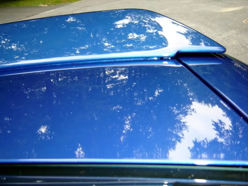

I bought the Meguair's kit a couple of weeks back and used it on the trunk lid, roof and hood. WOW! It was better than it had looked in the year I have owned it! I didn't even polish aftrwards, went straight for the wax. Next month I will probably do it to the entire car, this time polishing it as well. It is simple to do. As others mentioned, the key is to keep the car well lubricated and knead the clay often.
No prob.
I've got to ask, what prompted you to pick that username? I started laughing when I read it and my wife asked what was so funny!

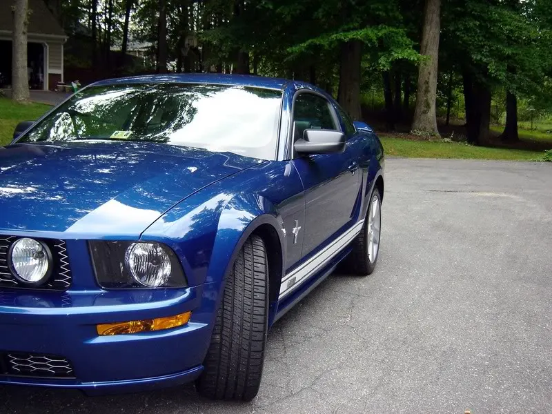

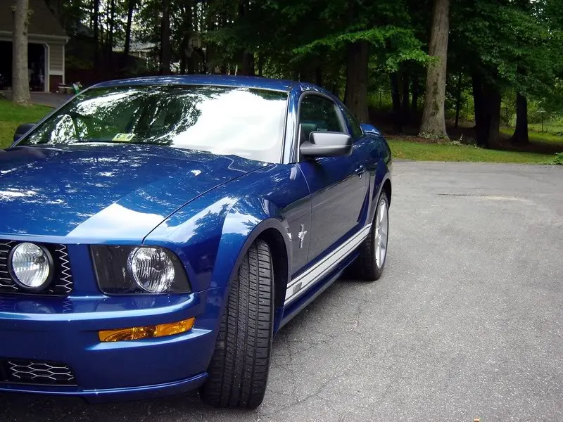

Edit: By the way, I can't let Kooldawg have all the glory (:D), here's an old pic after claying, polishing, then a coat of Opti-Seal. It reflected even more it seemed the next day after the sealant cured.
wow
That's one really nice lookin' car!
