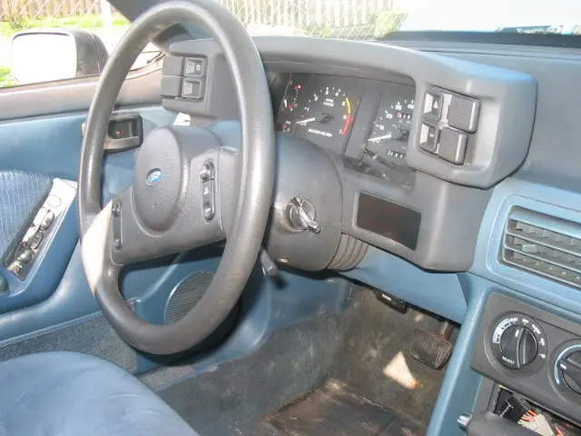

I got an extra interior for free and it is in really good shape, but it needs to be dyed. What dye are you guys using that works well and it reasonably priced?
25th your interior is dyed right? and Ryans too? What good dyes are you guys using? Thanks a lot.

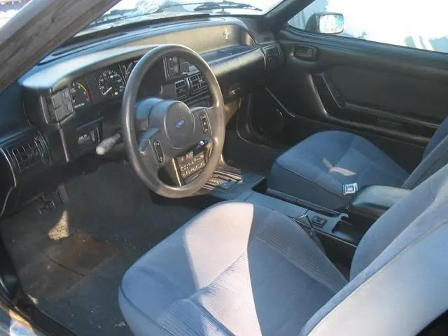

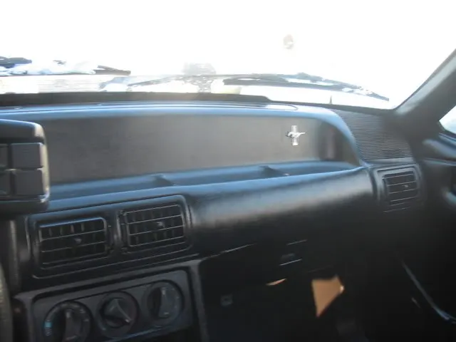

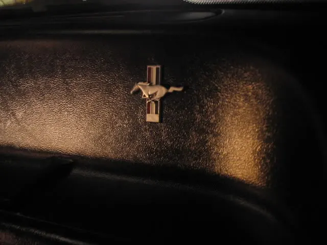

4k miles later and about 8 months later.
and since it was done it sits parked beside the garage in the sun...

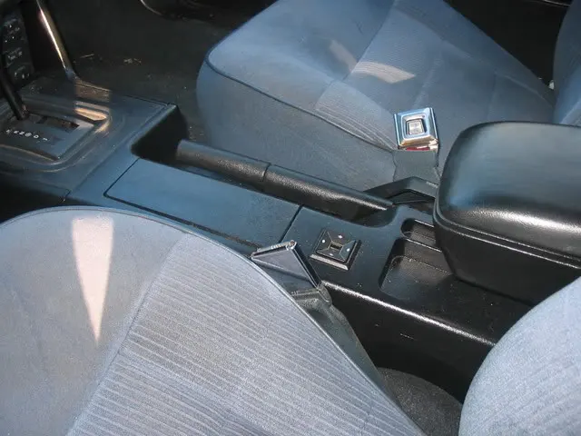

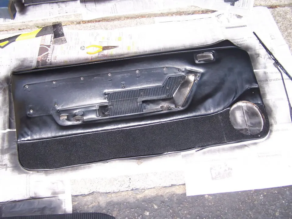

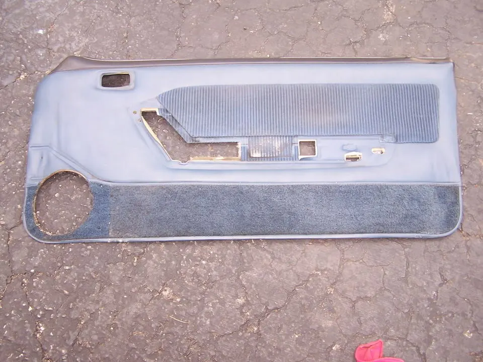

That looks good Ryan. Did you paint the door panels too? How are they holding up?
i dyed everything but seats and carpet...holding up amazing. its all in the prep. take your time and it will be fine.
and a few be fores...i know for a fact my interior was alot damn dirtier then any of yours could be....take your damn time then you wont be back here 3 weeks later bitching because it flakes off.
