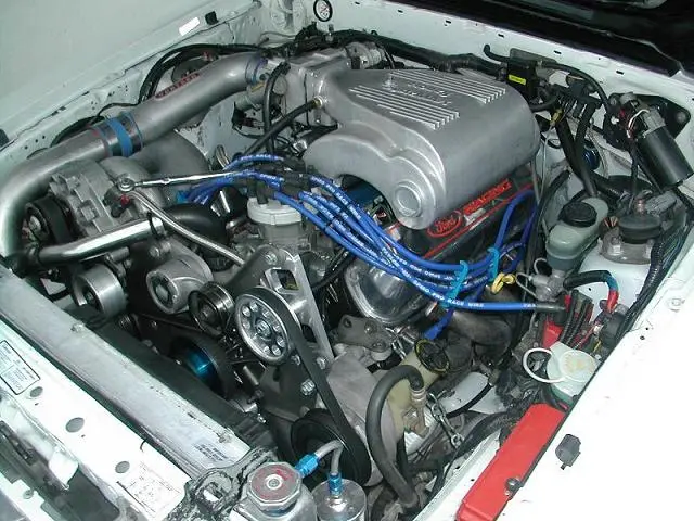

My 89 is making somewhere around 740 at the fly wheel.
Stock block 30 over, weisco pistons, stock rods, ARP bolts,
windage tray and a motorsport(fluiddamper) balancer.
Running a t-trim and cogs @ 22lbs of boost.
If you look on turbomustangs.com there is a guy from Pheonix
that claims around 680rwhp with a turbo car stockblock.
Heres a pic. of my coupe.
