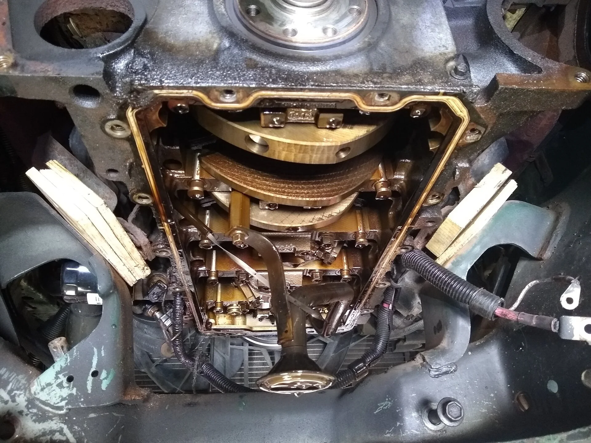

Yes, it is easier to remove the oil pan when there is no flywheel/transmission. All I had to do was lower the steering rack (two nuts and one bolt), take two nuts off of the motor mounts, and then raise the engine about an inch. I didn't have to lower the K-member.
