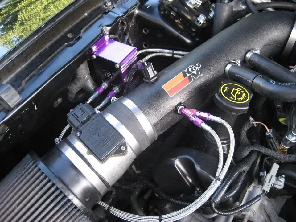

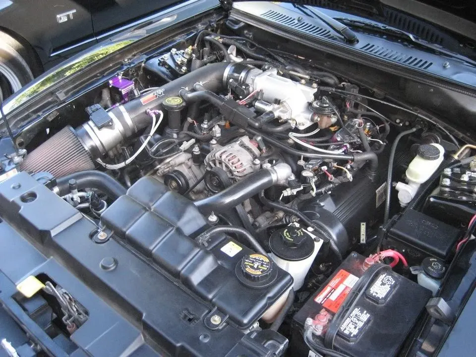

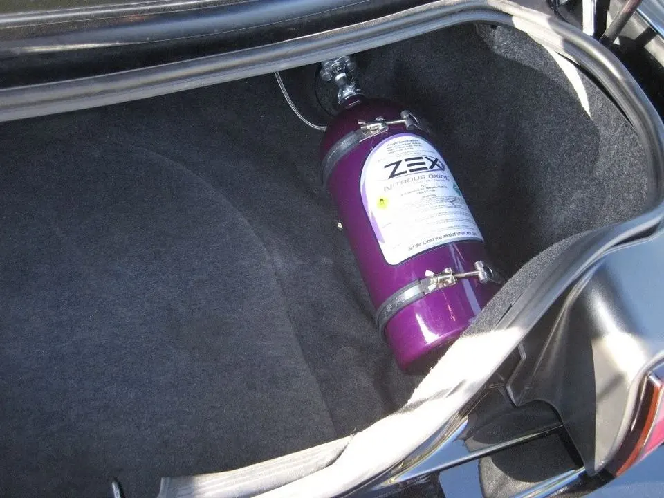

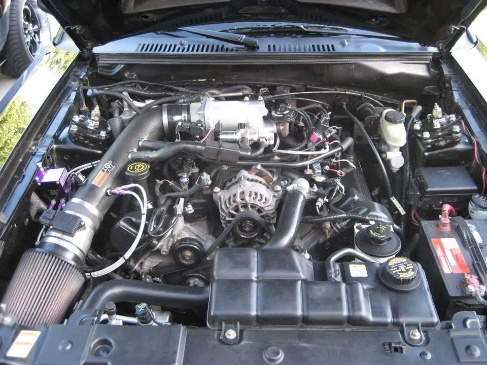

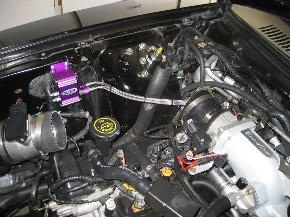

Zex adjustable kit installed on my ride. I set it for the 100 shot. Next up, I have to add the purge, blowdown tube, bottle gauge and heater :D

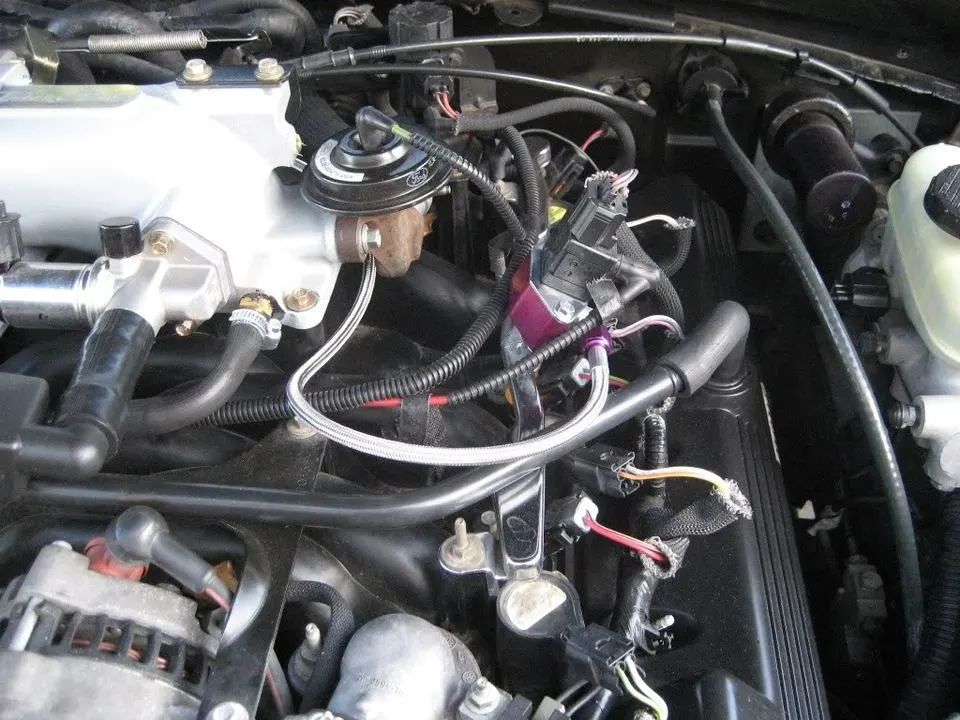

I installed my nitro right at the elbow bend, so the fuel will be pulled directly into the throttle body instead of spraying/splashing on the 90 degree bend. My instructions said to place about 6 inches from the TB. That ZEX setup looks nice, I like how they have the computer control unit to handle both input/output lines. I went ahead and slapped on the Typhoon intake manifold after some porting/flash removal work just to be on the safe side. I don't want to turn my hood into a shaker quite yet.

When I did my buddies I put it on the bend but he forgot the silicone. So I used JB weld and told him to get the paint in whatever color he likes then I will finnish sanding it and paint the whole pipe with the nut in place so it should look a little cleaner :shrug:
