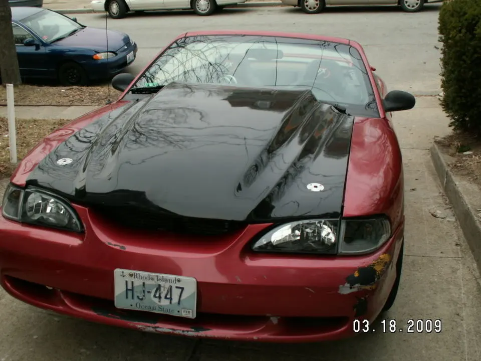

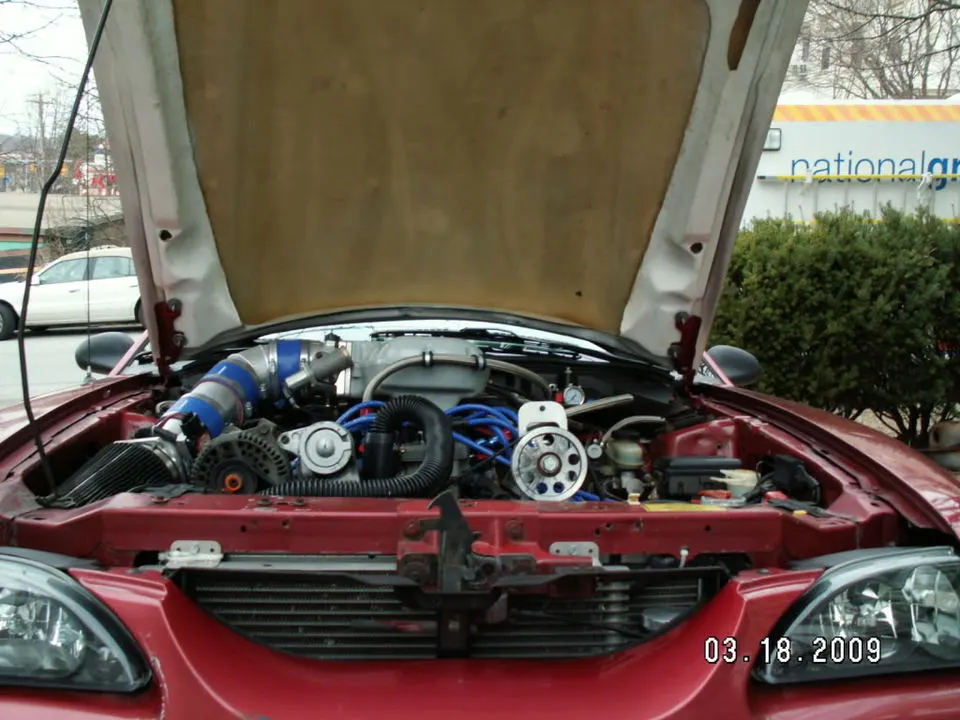

I've heard the regular R has problems with the design of the upper. The box would be a good choice however good luck finding a hood that will clear it on a 351. Its not gonna happen.
Ive used both the Reg R and now the box upper. You need a hood thats 4" cowl. And the cowl has to be higher in the front. Lowering mounts gives me about 3/4" clearance on my hood.
Its gotta get painted i know...
