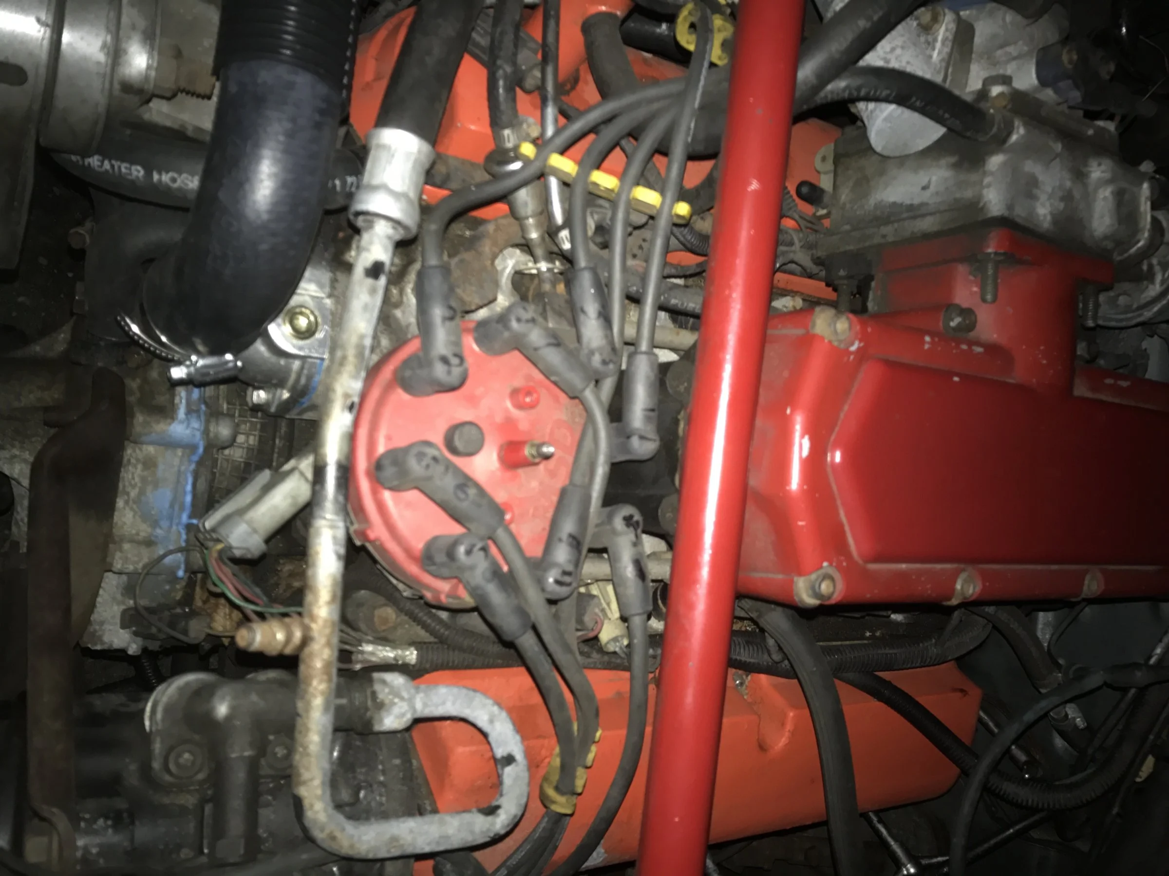

This fox is relatively new to me and I have no idea what this intake manifold is it's on a 1986 5.0 GT (won't let me post photo normally)

That's an old Comp Polymers Box upper intake.
Depending on which version you have, there's either a stock HO lower intake under it, or a GT40 style lower intake. It's more of a higher RPM sort of intake, and if you aren't running a power adder or nitrous, you might be better served putting a stock HO/explorer upper back on and gaining low end torque back.

Thanks soo much
