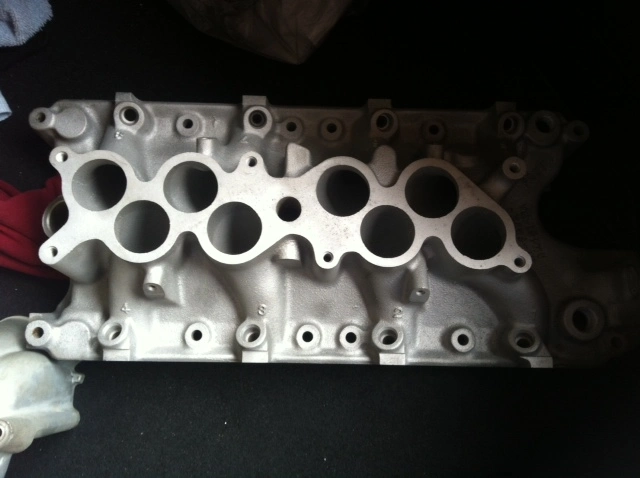

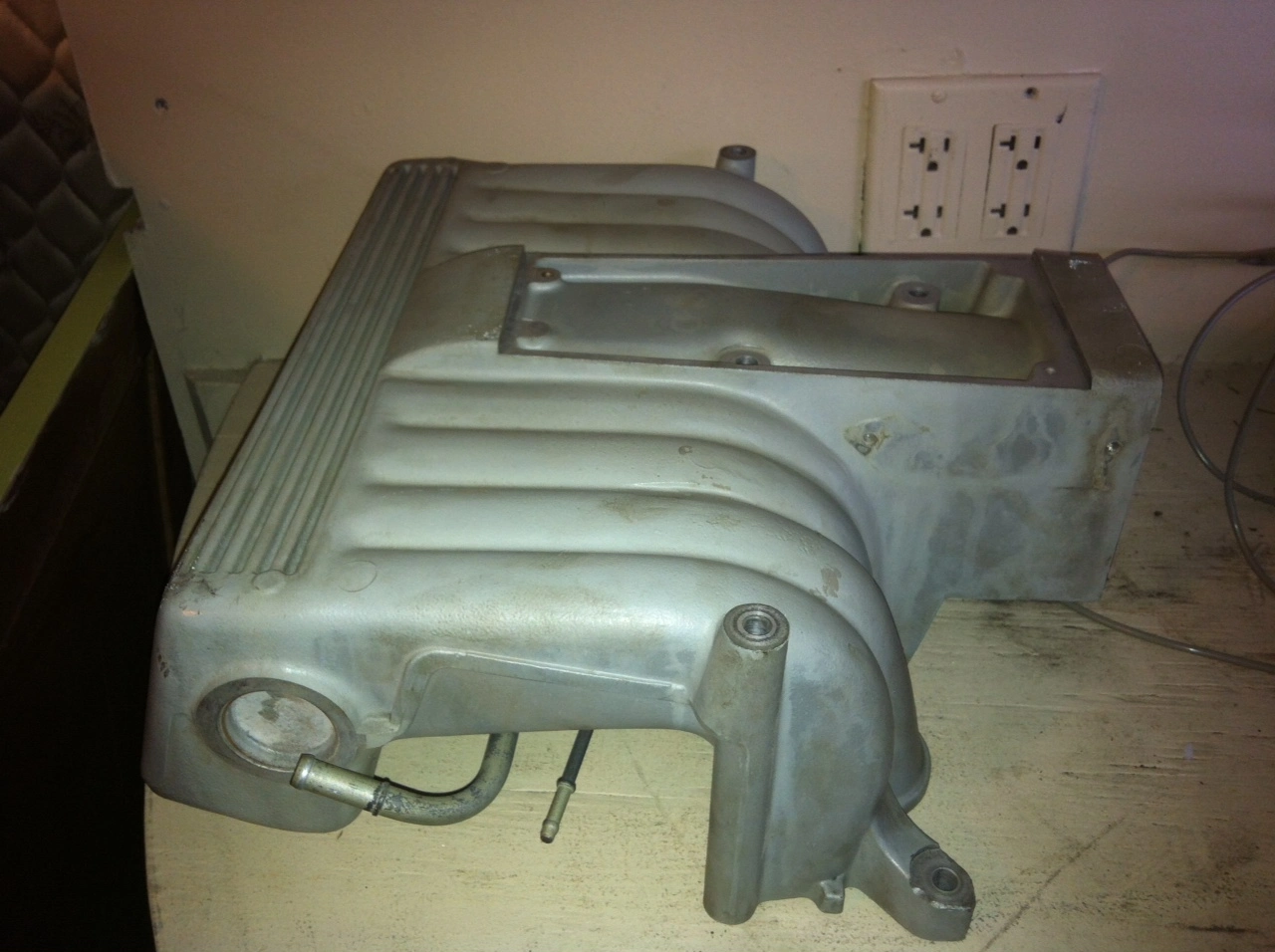

Explorer 5.0 intake. Similar to the Cobra and GT40 (tubular) intakes.

Someone is trying to tell me this is a GT40. Is this one any good and how much is it worth?

I don't remember how much they're worth (I sold one a few years back). Just check around eBay and craigslist and see what they're going for. It's pretty much equivalent to a GT40/Cobra intake. It's a decent step up from a stock 5.0 intake.

If you have it in front of you and don't need to pay shipping....$75-100 is the going rate.
You can go to a yard and snag one for $25-50.

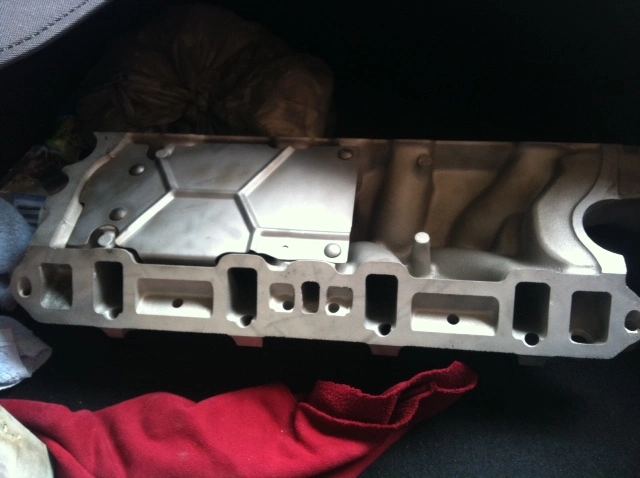

The lower intake is virtually the same used on the GT-40. The upper plenum is similar to the 93 Cobra. I think it has more internal voulme personally...meaning better low end torque.
It's an early Ford explorer intake...circa 1996-1997 with internal EGR

There are done extra steps for installing on an SN95 but its basically a cast gt-40 intake

That one is already cleaned up real nice.
They are worth the $75 bux you'd pay for one... beyond that though, I'd pass.
You have quite a bit of work to get one fitted to an SN95.
I picked up the SN95 specific version of the GT40 (94/95 Cobra upper) for our 94 GT, because I wanted plug-n-play, but now I wish I hadn't.
If I had it to do over, I would use the Fox version, like that, and I would have converted the car to Fox TB, throttle cable, etc... Instead of making the intake fit the car. Make sense? Make the car take the Fox intake, not try to turn the Fox intake into an SN95 with the adapter parts.
I paid big money for the SN Cobra, and I would have been better off buying the cheaper Fox part and converting the car.
Fox setups are known for better throttle response, more room around the engine for other mods, and cleaner looking final product.
If you get an Explorer intake like this one, get the TB off the donor car too. They are 65mm, and only need the linkage swapped to fit a Fox.

Oh, and if you keep your SN95 EGR system, you should use intake gaskets with the internal EGR passages blocked off.
You can get the block offs with the gaskets, and put them between the head and intake, or you can just tap and plug the hole in the top of the lower, between the 8 intake runner holes.
Really though, the 98-up Explorer intake is the way to go for SN95 cars. They have external EGR just like the 94-95 Mustang, so there is no internal plumbing to block off. The earlier intake like the one pictured is perfect for a Fox swap that is going to keep the EGR.

Yes, it will bolt up to your engine, no doubt about it. You just need an adapter elbow, and they are cheap. The explorer intake performs the same as the GT40. Oh, and don't do the Fox throttle body conversion. One of the huge advantages of the SN is the improved throttle body. Converting it to a Fox throttle body is going backwards. It's also cheaper too buy the elbow adapter than to get all the parts to convert it to a Fox throttle body. I've seen Explorer intakes go for as high as $200 on ebay, and they weren't as clean as that one. Use your judgement on price.
