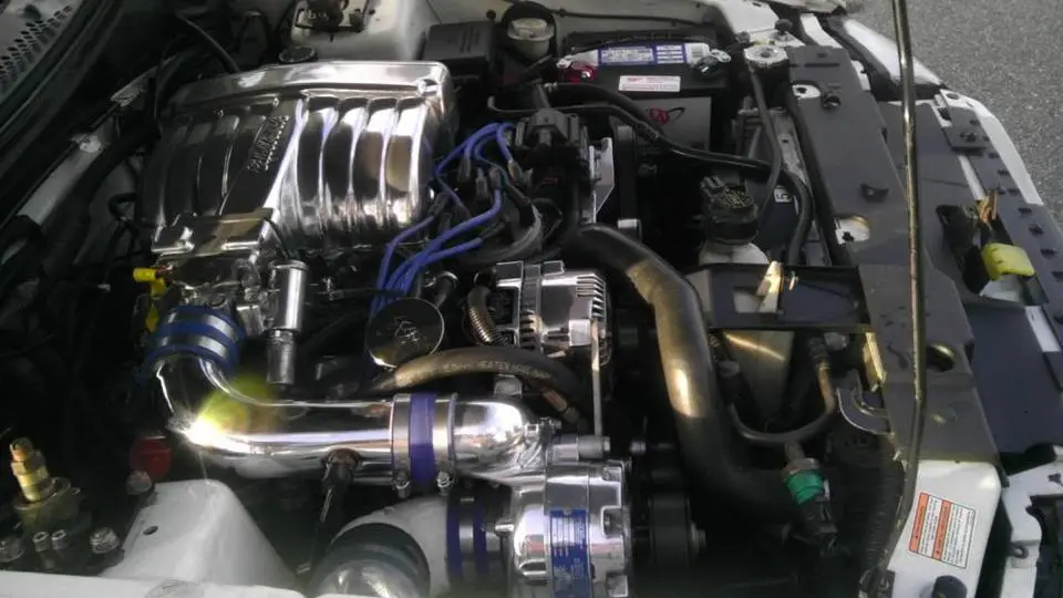

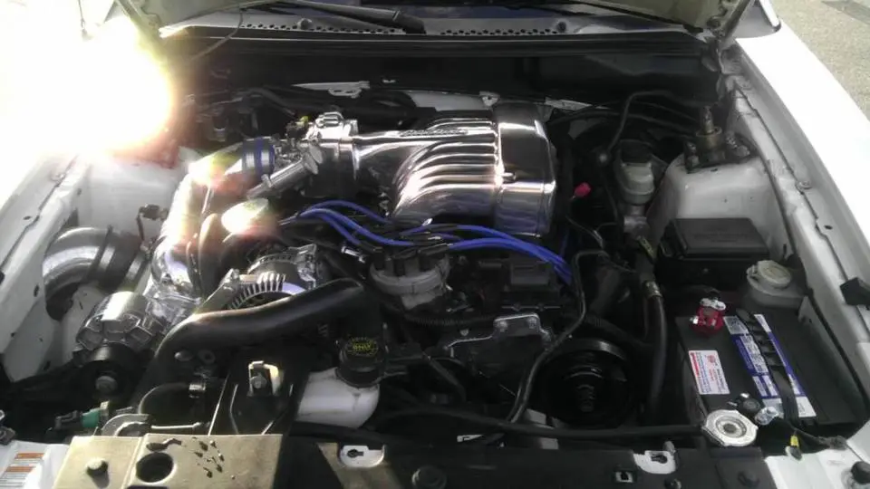

What intake manifold is this?
This is interesting... Very clean conversion.

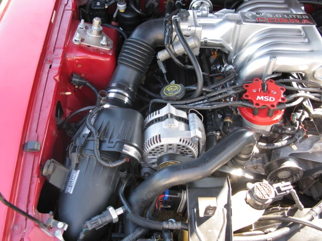

Out of ALL the Fox bodies I've owned and the 2 SN95 setups with Fox TB conversions I have NEVER had an issue with the linkage jamming. I also don't have any idle issues, my throttle blade opens faster for better response, I don't have to spend double the money for a throttle body, I can run taller Fox style valve covers and I don't have an ugly elbow cluttering up my engine bay. Ford used the elbow design because they had it laying in the T bird parts bin. Nothing more. It served no purpose but to save them money. T birds and Cougars were luxury/sport cars. A soft opening throttle blade was fine for them but not a Mustang.
I am totally an advocate of swapping to a Fox Throttle body. One of the best mods I ever made!
