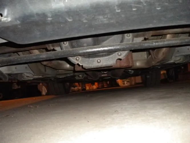

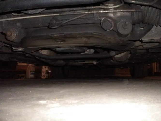

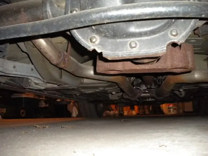

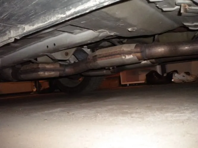

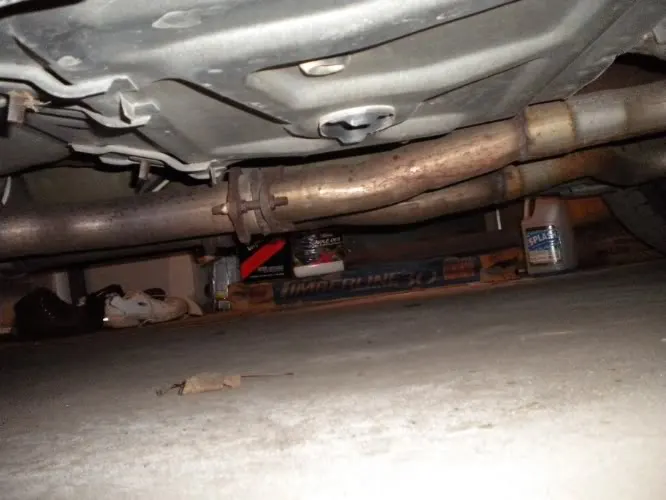

Hey guys, I just bought this 98 mustang gt
46k miles
It is a little loud... not too loud
But here is my concern
I just ordered the SLP loudmouth 1s...
this is my current exhaust set up that came with it..
can you help identify exactly what it is? Sorry if the pics dont help too much
and will the LM1s be much louder?
why is it louder than stock?........let's see........Oh yeah, it doesn't have any mufflers! the mufflers have been deleted. as already mentioned, the h-pipe is stock. I would think that any brand of mufflers would be quieter than the way it is now.
