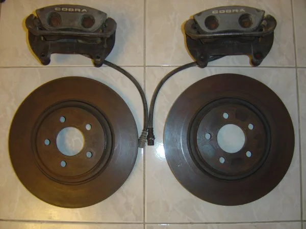

Dino Dino Bambino 15 Year Member Jun 13, 2007 1,672 89 79 Cyprus May 16, 2009 #5 May 16, 2009 #5 I just upgraded my front brakes to 13" Cobra units earlier this week and it's a fantastic mod. Parts required are: 13" Cobra front rotors Cobra PBR calipers Caliper brackets Caliper bracket to spindle bolts Brake hoses Brake hose to caliper banjo bolts 17" wheels to provide the required clearance Brake fluid This is what I picked up from a junkyard '98 Cobra for just $163:
