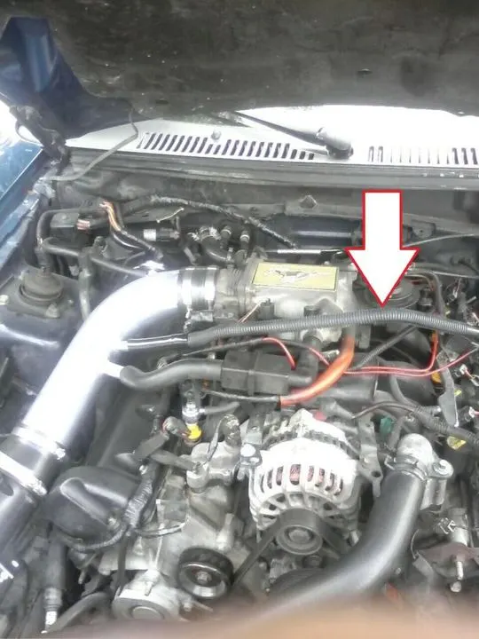

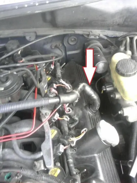

Can someone tell me what the tube is call that runs from the intake to the valve cover cant seem to figure out what it is called i need a replacement
It is a PCV vapor line that is part of the PCV system. The make up air comes from the tube into the engine. The crankcase vapors are drawn out via the PCV valve on the right hand valve covers. The vapors go into intake manifold where they are burned.
Thanks For the info but would u happen to know what the tube is called or where i can get a replacement
