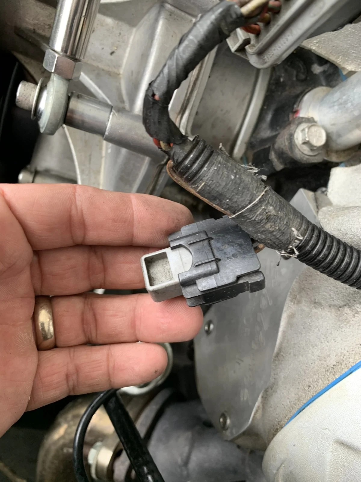

Xkuzme1 Member Sep 21, 2019 52 15 18 Kansas City, MO Oct 10, 2019 #1 Oct 10, 2019 #1 Trying to figure out what this part is?
Hoytster I don't dare do that to my Knob 20+ Year Stangneter Dec 30, 2002 1,069 700 164 Cornwall, PA Oct 10, 2019 #2 Oct 10, 2019 #2 Xkuzme1 said: Trying to figure out what this part is? Click to expand... That would be your SPOUT connector. You pull that out to disable the timing advance from the ECU so you can set base timing. Reactions: Xkuzme1
