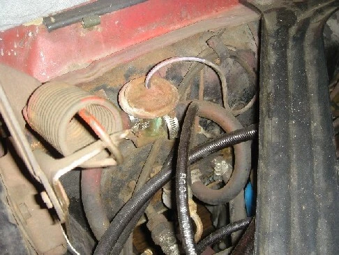

What is this thing-part of heating system in engine bay
That is the heater control valve. When you use the temp selector on the dashboard to increase or decrease the heat in the car, that valve adjusts the flow of coolant thru the heater core. If you intend to have heat in the car it certainly would be nice to be able to adjust it to your comfort. If you eliminated it your two choices would be, no heat or high heat all the time. There are manual valves made that have a valve that you could open and close manually, however this would be mounted on the engine, not very convenient to use.
Does your car have A/C? I was always told that when you turn on your A/C, this valve shuts off the coolant into the heater core. This keeps your interior cool and prevents hot air near the passenger's feet in the summer
I would think you should be able to remove it without issues. I don't thin it is a modulated valve is it? Just on/off.
I had a manual valve on mine ages ago just to keep the heat out of the interior in the summer but it did not have one from the factory (non A/C).
I'm curious how this might work with EFI since the EFI intake I have has the engine coolant temp sensor in line with the heater core hose/hardline.
I would think if this is turned off that the sensor would not be able to read the correct engine temp??

Let me try this again for a better picture. Look at this freakin rats nest of coolant hoses.
monk302 said:
Actually my car was an air conditioned car. No longer though. I removed the condenser a while back. Should I leave it on or take it off? I don't use my air conditioner any more.
Did you convert the switch to a heater only or does it have the A/C controls on it too? See on the 69/70 (what i'm most knowledgeable in), the non-a/c cars had cable only controls to switch from floor to vent and hot to cold (had electric for on/off though). The A/C cars had the floor to vent operated by vacuum, thus the vacuum line coming through the firewall and going to the heater control valve. Non A/C cars did not have any vacuum lines for the heater system so you obviously wouldn't have this valve. It is OK to leave it on, as it stays open when there is no vacuum applied. Not the prettiest thing, so if you want to tidy up your engine bay you might take it off. HTH
The switch has both heater and A/C controls. Though my controls operate an electric fan that pushes hot air into the cabin. Though even without the electric motor it is still dropping extremely hot air to the feet of both the driver and passenger. With your post above being said I think I may take it out. It is really an eyesore that doesn't seem to be too functional.
