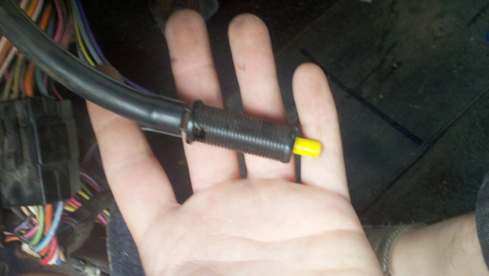

I recently picked up my first fox. I was working under the dash and found this button. what is it?
also i could use a wiring diagram for the reverse lights if anyone has one.

If it is over by the glove box, trunk/hatch release or gas door release

I think that's for the cruise control, to turn it off when depressing either the clutch or brake, can't remember which.
Ah that sounds correct.
YEP. It is the vacuum hose for the CC that is supposed to be attached the brake pedal. When you depress it, it turns the CC off by opening the vacuum valve on bladder.
