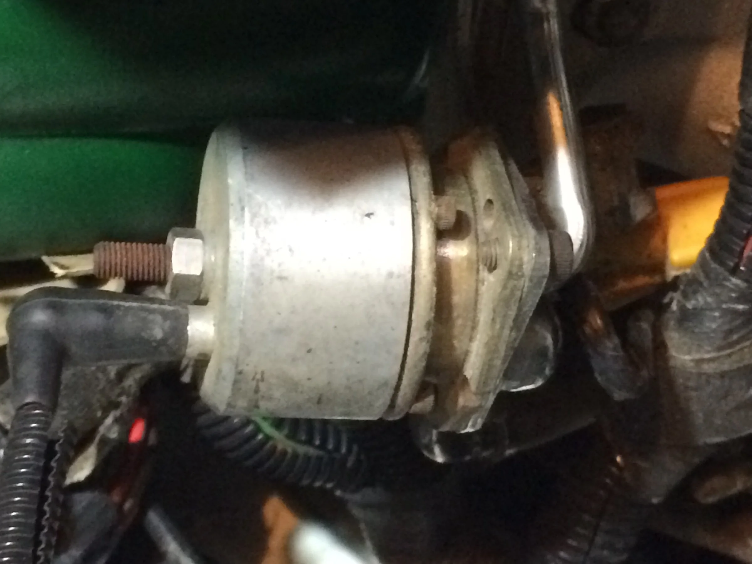

What Is This ?
j0rd4n
Jul 29, 2013
169
12

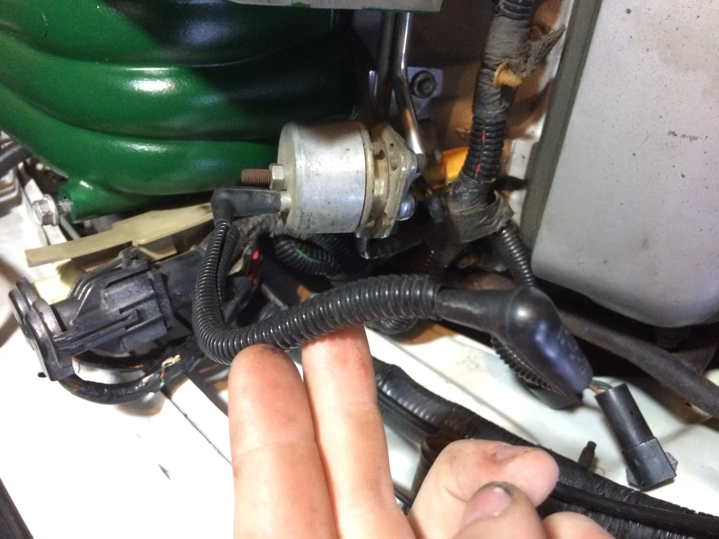

I'm guessing it's something to do with fuel pressure considering It's on the rail but where should the vaccuum line go ? My guess is the egr valve that's the only thing I could see is reaching. I'm going to be replacing the egr with a delete bracket so do I just need to supply
It vacuum from another source ?
I can't remember where I took it
From when I began this gt40 intake swap
Thanks everyone
Has nothing to do with your Egr . It's the fuel prsssure regulator. Needs to be supplied it's own vac source from the intake
That regulator is adjustable. I would replace it with a non-adjustable unless you need that functionality for some reason.
the guy i bought it from put it on im not sure why. the car was originally a 4 banger and when i changed the fuel pump he still had the 60lph pump in it.. should i just get a new one from autozone or go for a bettter quality?
