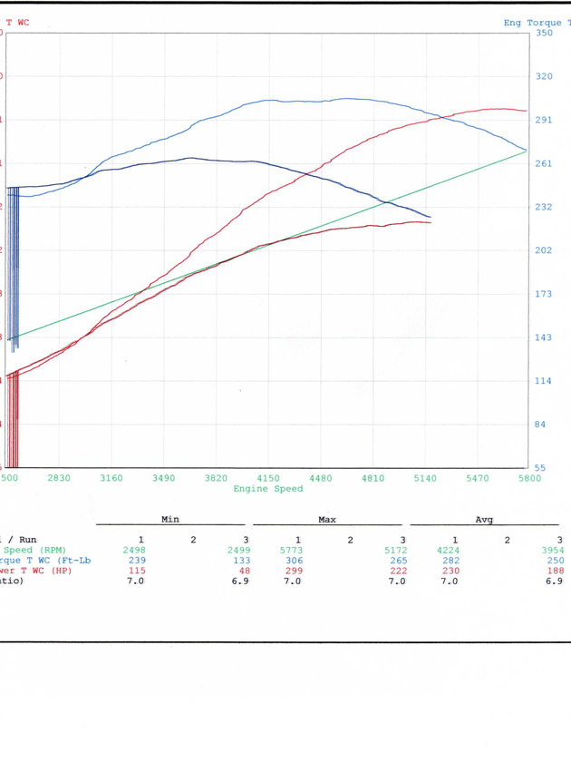

Just got back from the dyno after I put on my afr165's and FTI cam and scorpion rr. Graph shows baseline with mods in sig including cobra upper and lower. Lower was ported for afr heads by Tmoss during head installation. Fuel system is completely stock. Unfortunately no A/F ratio was measured. Official numbers were 300.3rwhp at 5500rpm and 306.6rwtq at 4700rpm.

Stock ign system? Is the timing advanced?

ignition is totally stock except for wires and cap n rotor. Timing for the run was set at 18* advanced
Additionally, no tuning of any kind was performed on the computer, fuel pressure or the timing. So I'm betting theres still some more left in this combo.
