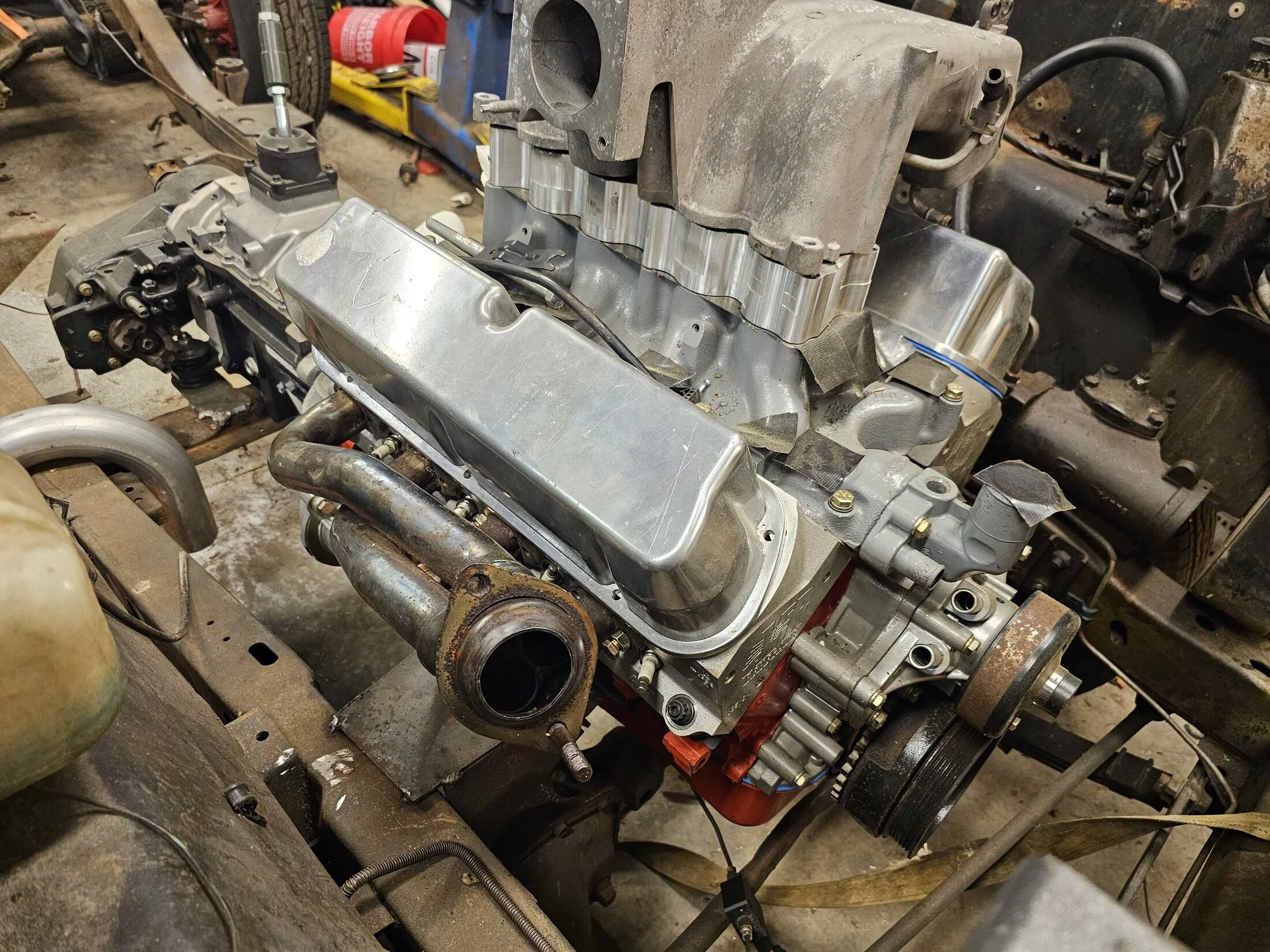

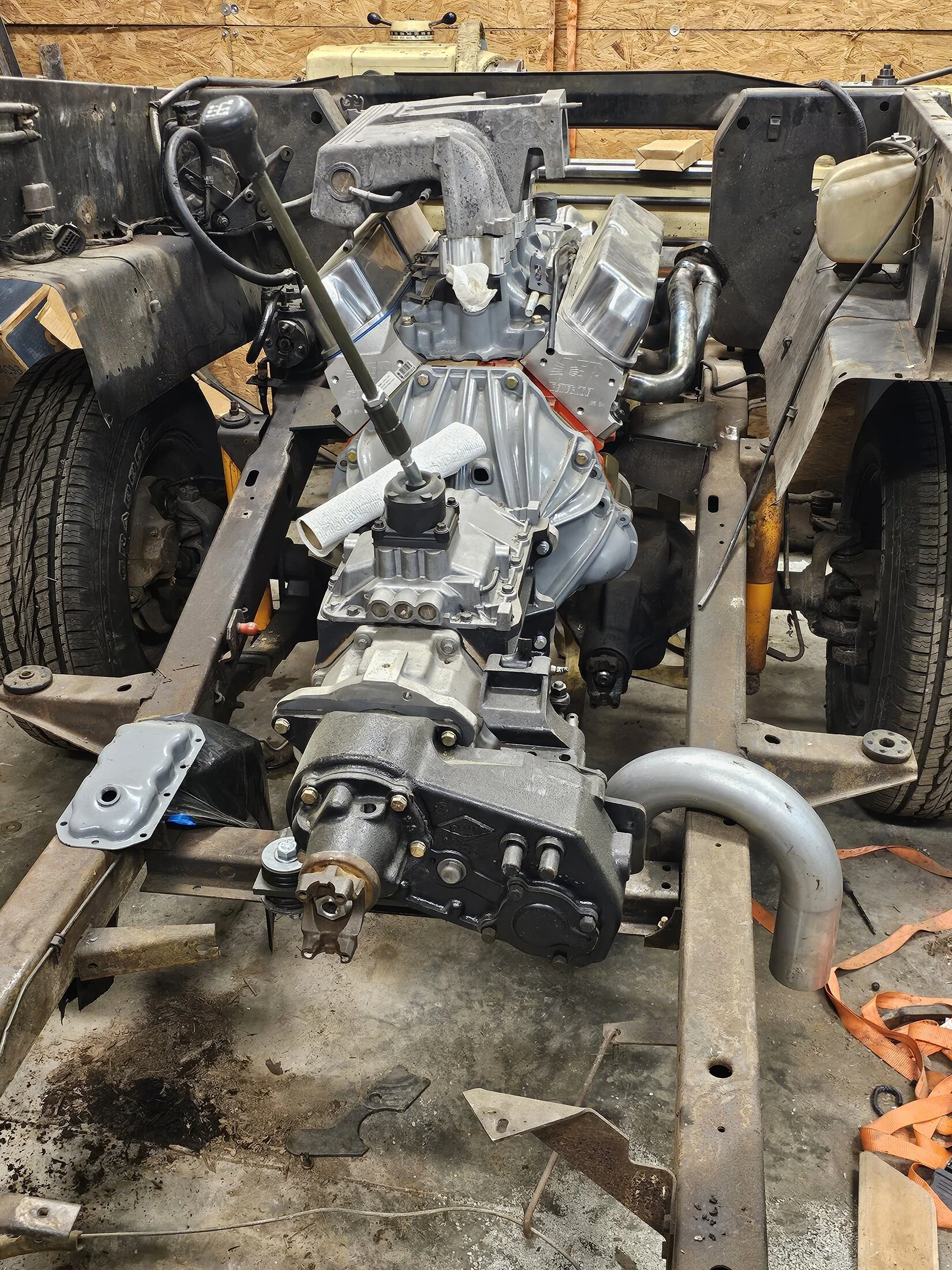

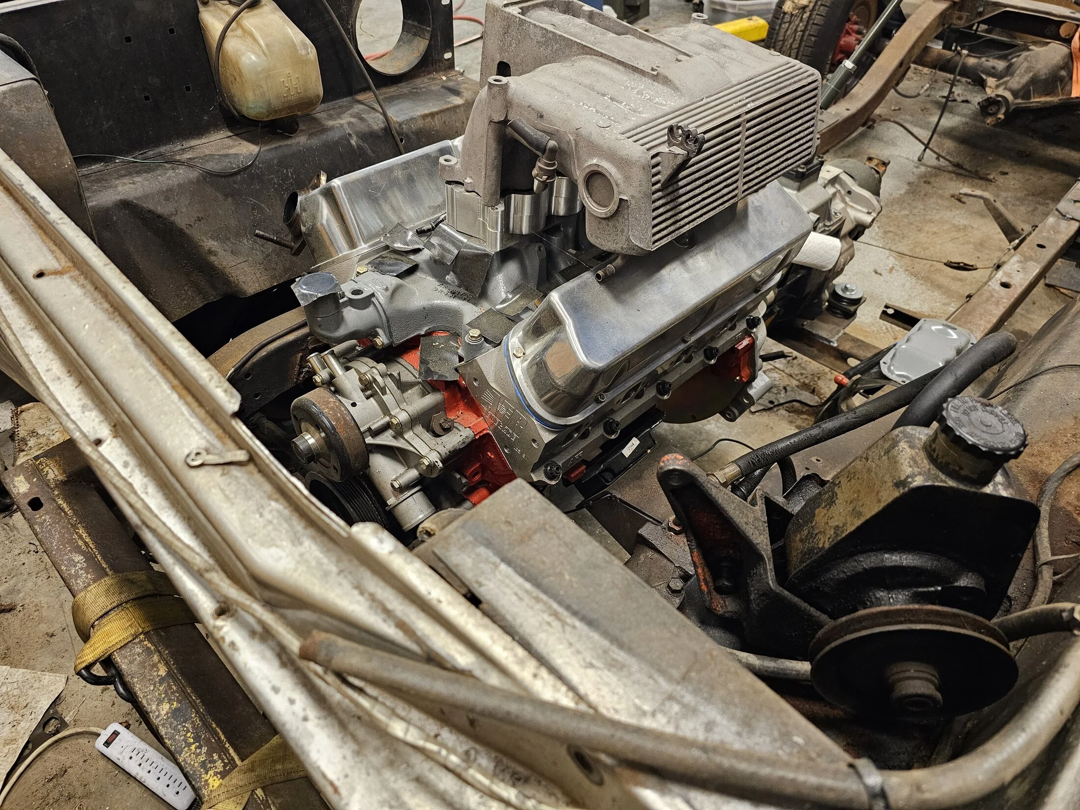

Is this a running and driving project? How far along is it?
You should post pictures, everything these days seems to be an LS swap, so it would be nice to see something with a pushrod 5.0.
