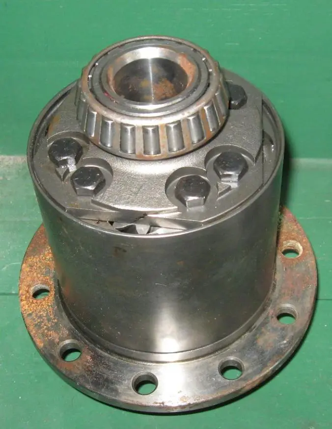

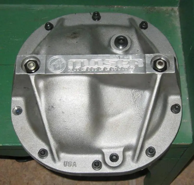

I was given a diff and cover for a 31 spline 8.8" rear.
The diff doesn't have any info on it other than a few numbers.
The parts supposedly came out of a Saleen Stang of unknown year.
The diff was said to be original. Don't know or care about the cover.
I would like to know:
Brand name?
Type?
Is it a locker, or just limited slip? (it has no clutches like Trac-Lock)
Is it considered durable?
Do I need special bolts for the ring gear, or can I just use the ring
gear bolts from my open carrier?
Any other info?
Thanks!
Dave

Trueblue got it dead on.
I checked the part numbers and they match the Detroit Truetrac.
It is a "parallel gear" limited slip. Identical to Torsen's T2 design.
The Stang has 28 splines (I assume), so this thing is going in my F150.
The GT has a LS unit already as well. The F150 is open.
