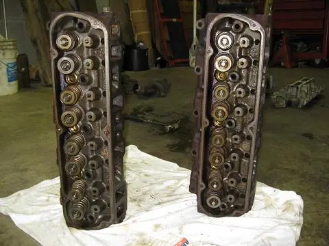

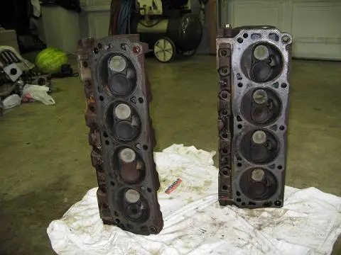

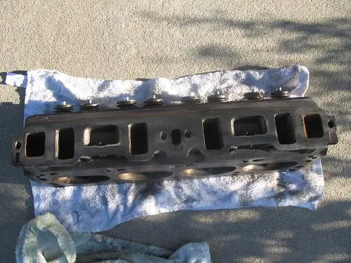

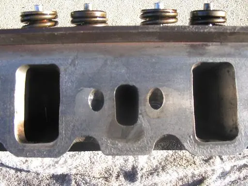

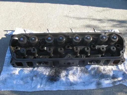

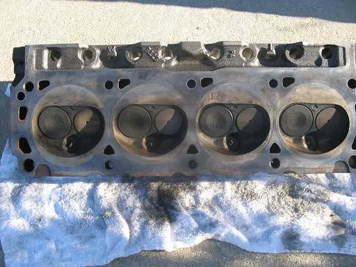

Got the guy down to $175 on the P's
but I found a full ported set of E7 that the guy ran 12.9x on for $220
which would be best bet?
Got more info on the E7's, including what his combo was that went 12.9? If he had a supercharger then it's not that impressive of a # but if he was N/A then it is... make sense? :)
I kinda like the P's for the cost and the power potential, but the E7's had the plus of not needing different headers (if your shorties won't work with P's). I'd buy the P's just to resell if nothing else. :)
See what everyone else says. Like I said above, I was contemplating running a "better" stock head but ended up with a good deal on some aluminum heads after doing some looking around, the power potential, resale and weight savings got to me.
Wes
Wes
E7 89 vert 1.6rr, e cam, 3.73, drag radials, cobra intake, full exhaust
