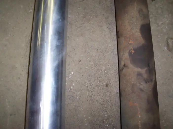

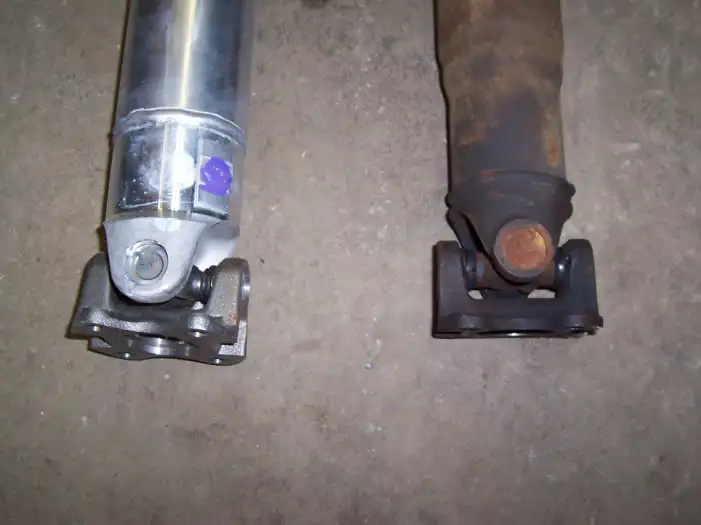

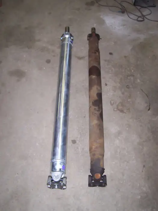

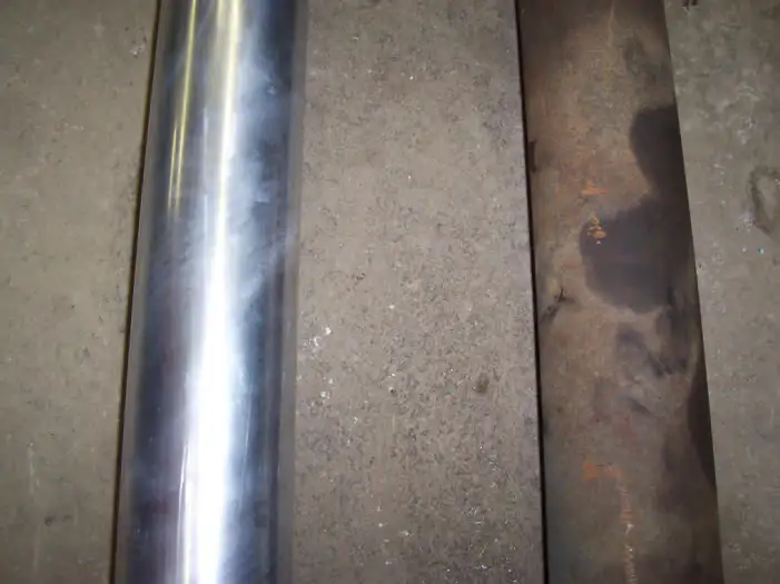

One more thing , is this alu driveshaft wider than stock one, I had problem with e-brake cable but I fixed that long time ago

on foxes, the alum DS is a half inch bigger than the stocker (per Mav, over in 5.0 tech. he just measured both of his. we have clearance issues too, sometimes).
im about positive you use the same alum DS as a fox does, but dont know if your stock DS is more beefed up or something (larger diameter) than fox stock DS's are.

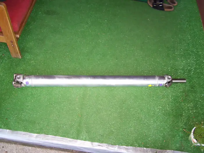

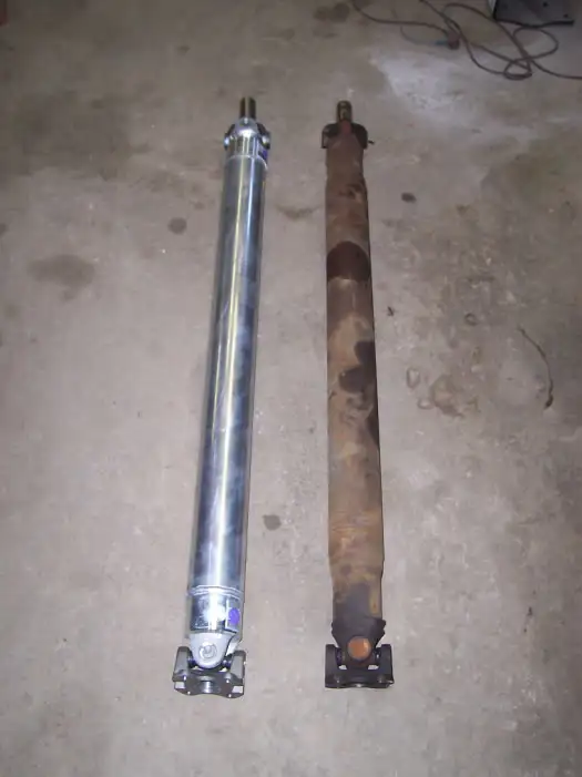

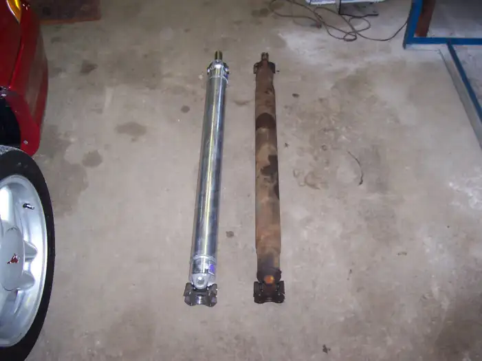

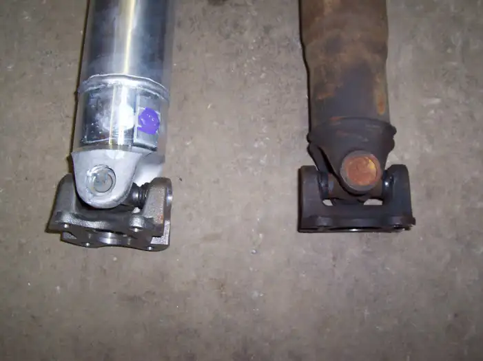

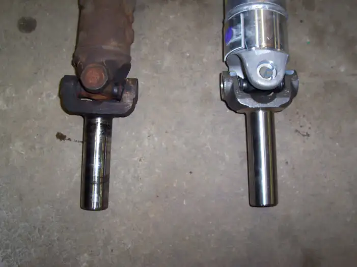

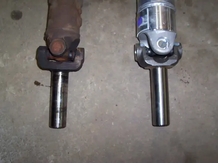

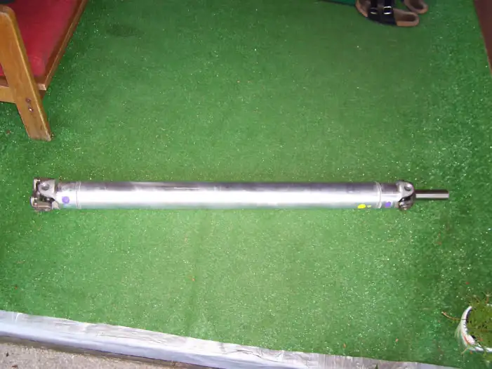

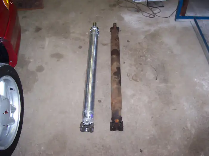

Yesterday I installed mine alu driveshaft , take me 45min , I could do faster if I don't have huge flows, to tight to put over flows
Here is some pics
