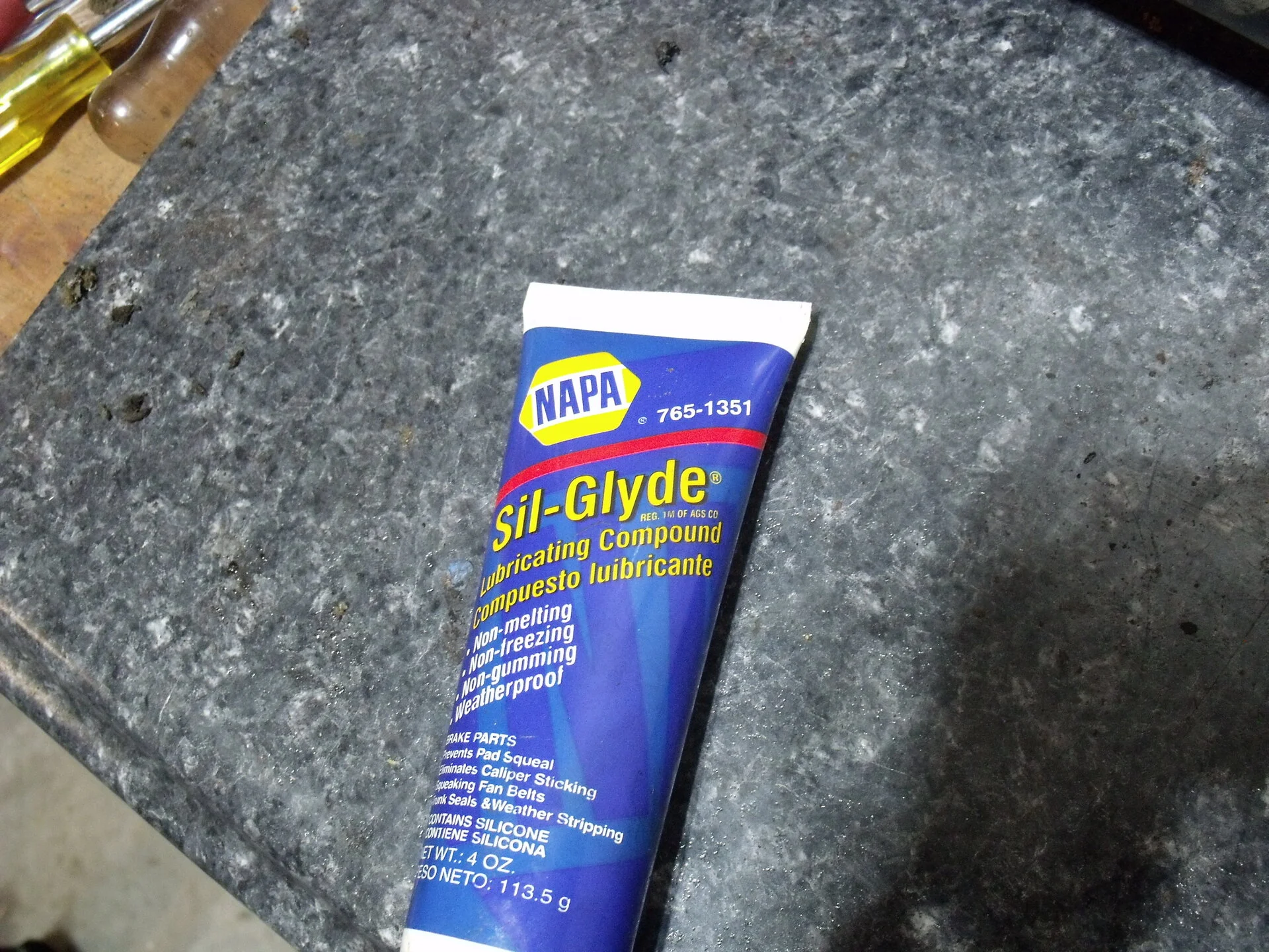

My favorite parts place ( Before they sold out to NAPA) turned me on to this Napa brand silicone lube for some brake work I was doing 30 or so years ago..... This stuff is really handy around the garage.. I think this is my 3rd tube....
Reactions: AnthonyA1234
Most parts stores have that for around $10 a tube from the oem AGS, same company that makes all those tiny lube packs they push at the counter with every sale.
