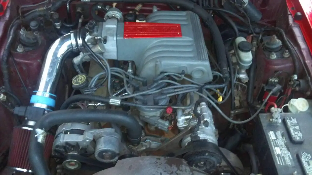

Definitely gonna do the sub frame connectors next.. and that's a pic of my bay not sure what's all done or not done I was just told its a gt40 intake... idk tho.

I'd get rid of that aftermarket intake as well. Go back to a stock airbox and tube, or at an absolute minimum a fender well intake system. The way it's currently set up you'll get terrible heat soak with that cone filter.

That is definantly a explorer intake. DONT make any changes to your intake tract setup. your car may have an aftermarket maf on it that is designed to be used with a conicle filter mounted directly on the maf. Do a little researching before you make any changes as this can cause some unsavory issues.....

Yea its some kinda aftermarket maf don't remember without looking but it comes with interchangeable "tubes" and I know the car has been on a Dino before b/c of all the paperwork I found in the car after I bought it no number sheets tho :-( I know it has still has 2:73 gear... but idk what else is done looks like a underdrive pully set too.. how can I tell if the heads have had work? Or have been changed out? Is flashing the computer possible too? Only reason I ask all this is because even with the 2:73 high gear I'm blowing away other fox body's with a lot of bolt on's and 3:73 anyone have any kinda help with all that? Everyone around here say b/c its only got 53k original that's y it runs so hard.. I think they all are wrong.. thanks again for any help on this

You have a C&L maf on the car... this unit is designed to run the way it is setup so i would not make any changes to the intake tract.. check the heads and see if they have any (bars) on the front of them gt 40 heads have 3 bars that run verticly on the ends of the heads... this is the only way i know to tell the differance without pulling the head.
Also pull the maf housing and let me know what color is on the tube and ill let you know what size injectors the car is running.
