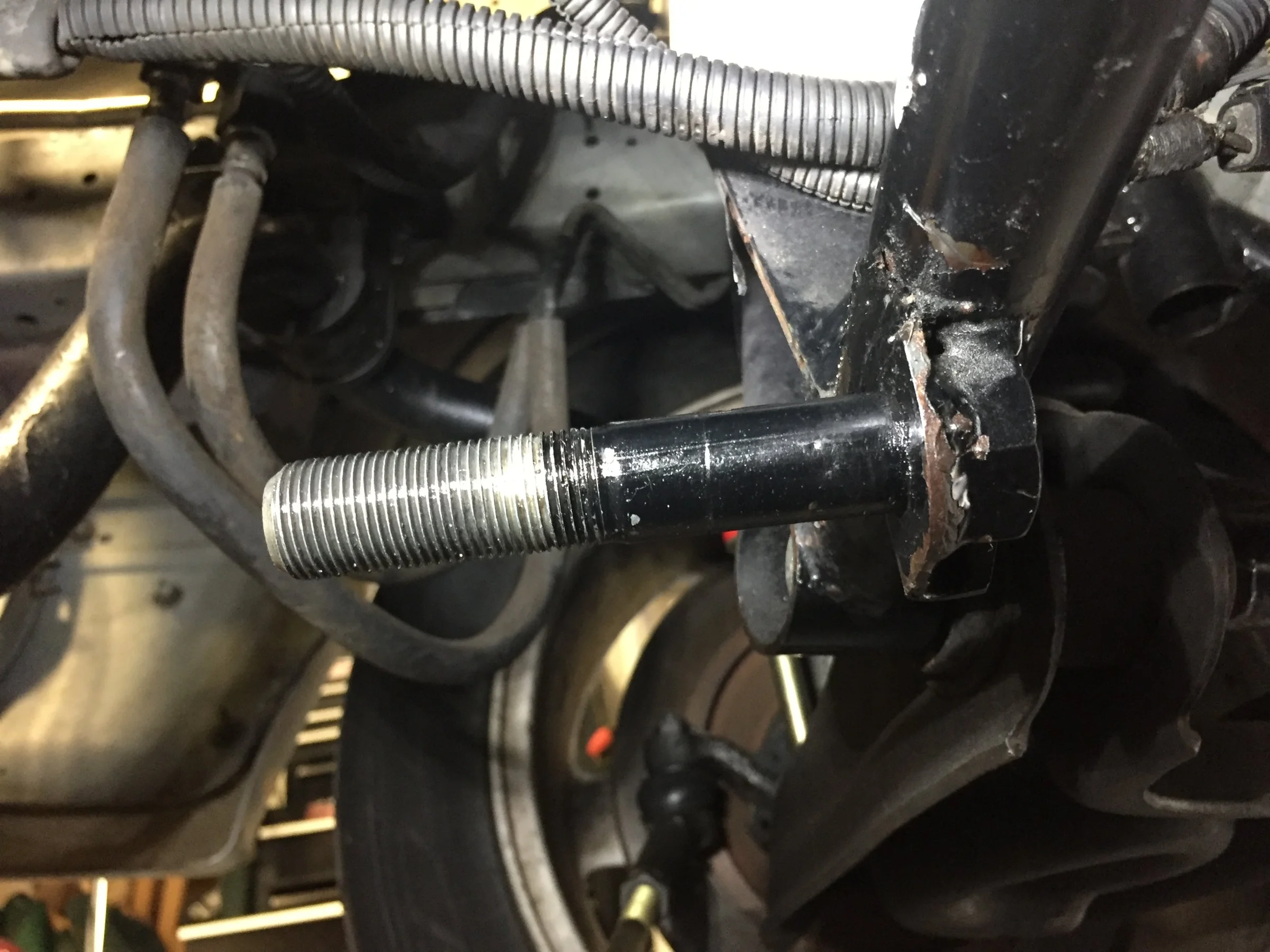

My 1992 Mustang has an aftermarket (AJE Racing) K-member, that doesn't look like anything in their current catalog (all round tube). The steering rack bolts are actually welded in as part of the K-Member. I don't know if this was done by the previous owner, or if it was offered by AJE.
The problem is, the bolts are 3/4" diameter, rather than the skinnier bolts with 5/8" sleeve that I see being used currently. I cannot find bushings to fit.
When I bought the car it had Poly 1/4" offset bushings, that fit tight over the 3/4" bolt (no sleeve). I didn't think anything about it, until I started going after some loose steering issues. The rack itself was quite warn, and it was difficult to keep in my lane at freeway speeds.
I replaced the old rack with a 2004 Cobra (Cardone Rmfd) rack and MM steering shaft, and installed new Poly offset bushings. I just couldn't get them tight enough without the sleeve to cinch against. I have been driving it this way for a little while, and constantly checking the bushings (the 04 Cobra rack feels awesome, by the way), but need a permanent solution.

- Poly bushings, can't get them tight without the proper bolt/sleeve
- 1-Piece bushings (includes metal insert), but the ones I tried (Moog K8263) were 5/8" and wouldn't go over the 3/4" bolt
I don't want to replace the K-Member, and I really don't want to have someone cut off the old mounting bolts and re-fabricate a new mount.

Hmmm.... plenty of speed shops out in this area for sure.. but as far as a fabricator I would find no less than a racecar chassis builder to go that route. You don't want a failure.
Now what stopping you from altering a set of bushings you have now? An 11/16 drill bit run thru the bushing to still allow a tight fit. Use some silicon spray on the bolt to install the bushing......
Personally I would attempt to alter a bushing slightly before I hackedup the k member.

I tried to drill the bushings out myself last weekend, but tore up a new titanium bit in the process. Barely chamfered the edge. However, I was using a hand drill instead of a press. I didn't even think about having a shop drill them out for me.
That should work, thanks!!!
