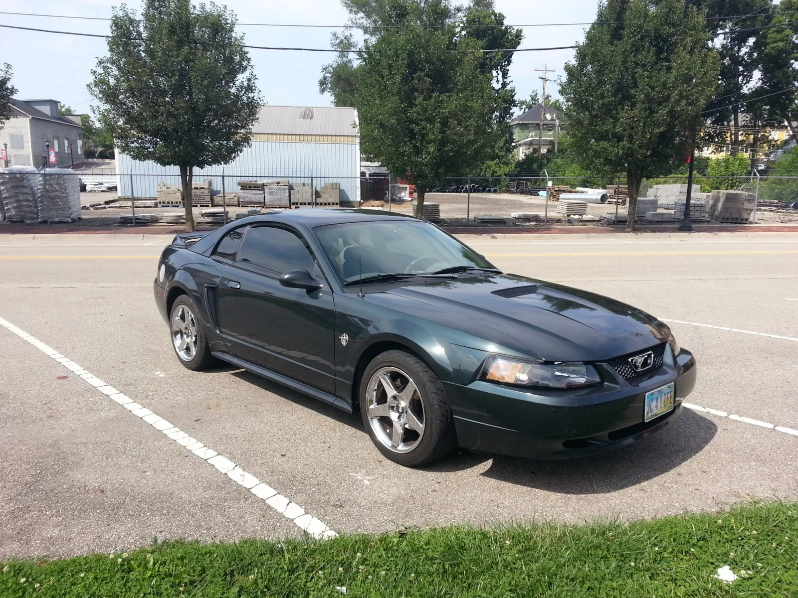

This is my 99 GT It Has alot of work done to it
