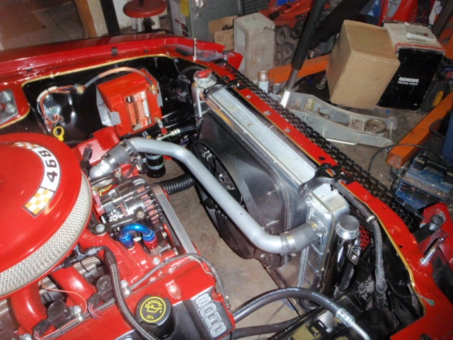

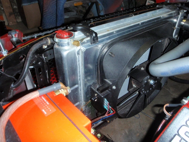

Jegs sells an aluminum thin profile shroud that you will have to screw, or rivet to the radiator. (99.00) They also sell their version of a Derale tornado that is a high CFM unit w/ a built in adjustable thermostat w/ a manual and A/C over ride. (139.00) I use this combo on my aluminum radiator, and it runs perfectly at the temp of my T stat. I also have a Jegs SS overflow Tube catch can. ( cant be called much more than that, it's only 2" in diameter)
I can take a pic if you wanna see it,...I like to take pictures:D

Thanks. I would like to see a pic
NewToFord
That looks really good, but I am still using the factory clutch fan, not an electric fan.
You'll have to adapt the plastic shroud then. The fact that the radiator is thicker only means that the fan will intrude further into the shroud. As long as it isn't hitting the radiator itself, then there shouldn't be any problem.
