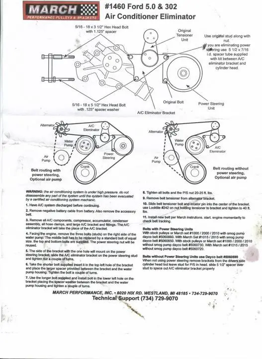

JASON. from what i remember the belt i used for a smog delete with a set of pulleys was a 770K6 belt. i have so many belts laying in the garage its hard for me to remember for sure. this diagram should help you find what your looking for. if you need help im me. joe
