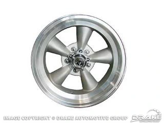

These wheels are 17x8 and require no spacers or special studs. The late-model "Bullitt" wheels are an imitation of the original Torque-Thrust wheels, made to fit the offset of the modern Mustang, these are what they are imitating:
