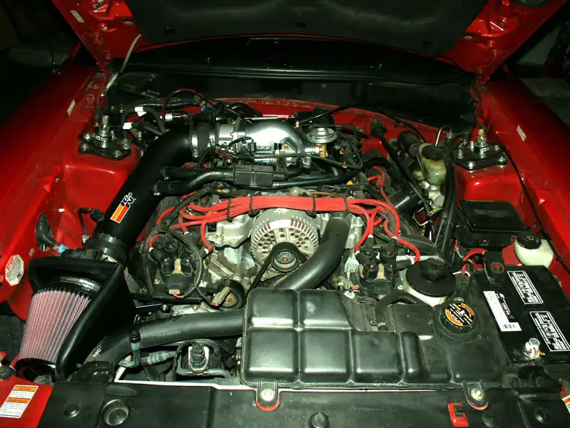

I went with FRPP 9mm as my first replacements. The distributer plugs started breaking within a year (in the hot Vegas heat). Then I bought MSD super conductors. 8.5mm. I've had them for three years now, no problems (and they look good too.)
Btw, I use NGK iridium IXs iridium (not platinum), TRX55. Great plugs.
ON EDIT: I meant "distributer plug caps" and not "distributer plugs". The plastic caps on the wires were breaking.

I coil setup on the older mustangs. The coil is one unit for each side of the engine. The newer mustangs come with a coil that plugs into the spark plug and they run right by the fuel rails or close anyways.
