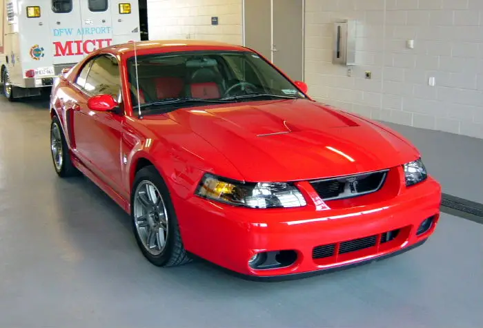

I lowered my '03 with an Eibach pro-kit. I am very happy with the handling, I like low cars and another 1/2' or so would look wicked- But I dont think I wanna go any lower on this one...I dont think you can without adding a bumpsteer kit and Caster/Camber plates to keep the geometry correct anyway. I had mine re-alligned immediately after the install and they got me to where I was barely off- not noticeable and hasnt been a problem. Any lower would require added work though.

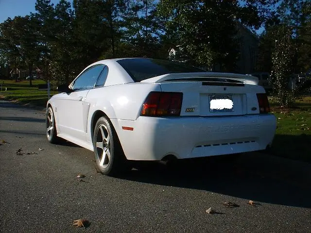

Here's the Steeda Sports with '03 Bilsteins. I have since swapped out for the Eibachs that were originally on a GT, which IMO are almost the perfect height. I am about to swap again though this time to coil overs.
