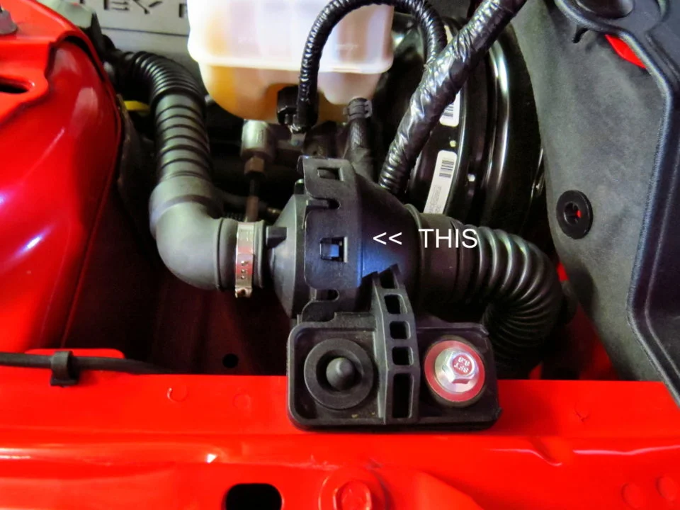

This is attached to the intake tube of my 2014 GT 5.0...what is it for??:confused:
That's your sound tube. Ford pipes some intake noise into the cabin through this to make the quiet muffler sound a little more aggressive. You can safely pull and cap it if you don't like it.

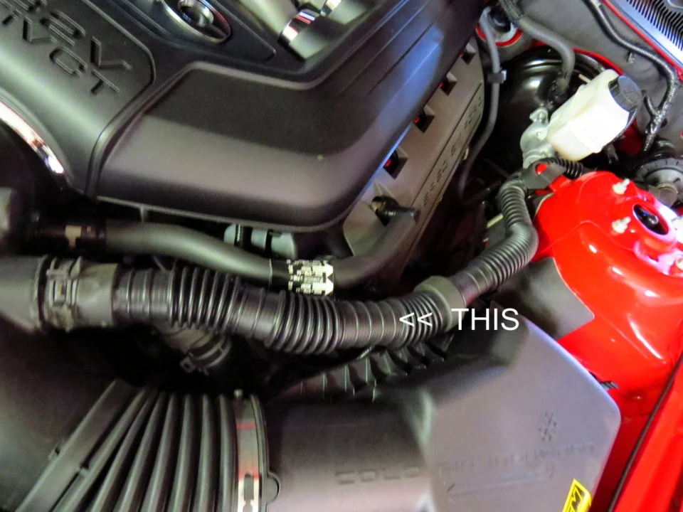

I removed mine. The result is a much cleaner looking engine bay. The interior is noticeably quieter. All I hear now is the exhaust. I have an Airaid CAI which can be installed with or without the sound tube, and includes the necessary plugs if you chose to remove it/ Here is a write up from another website on how to remove it:

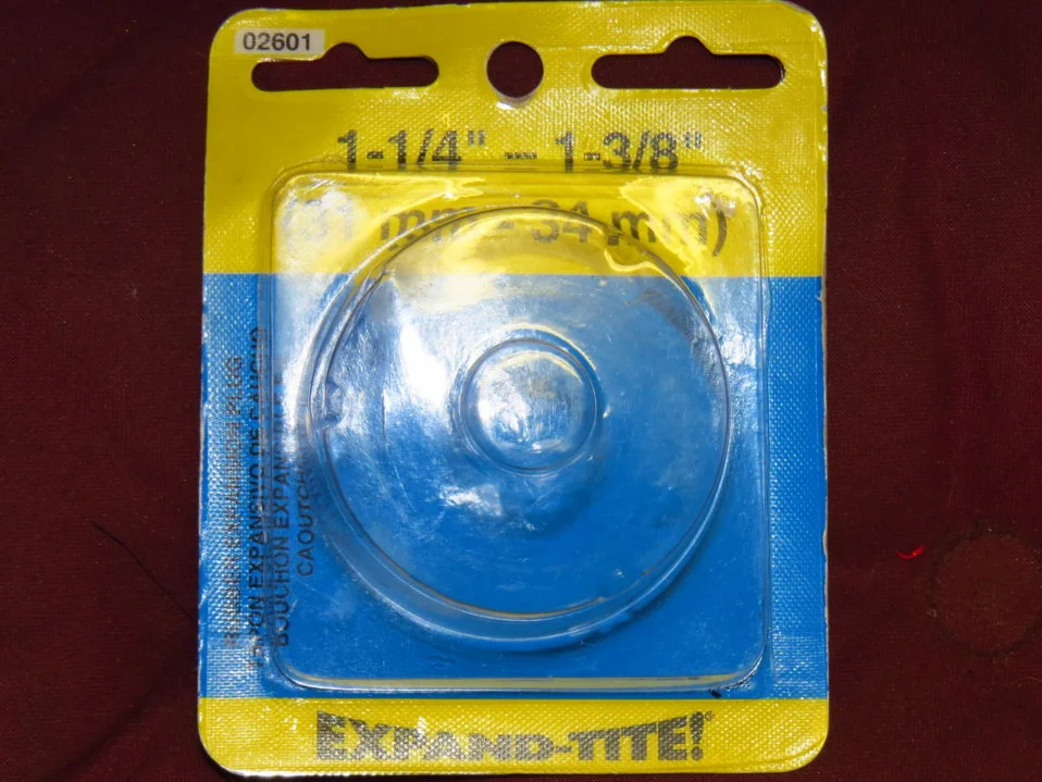

I plan to remove mine today and found an expandable rubber freeze plug that fits the intake tube hole perfectly and a Master cylinder gasket for the firewall!!

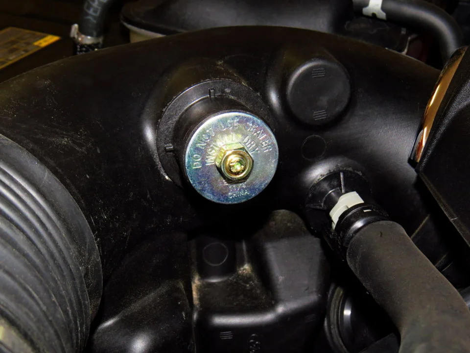

I took the gray foam out of mine today and it sounded terrible so I just removed the whole thing and it sounds much better to me with my Magnaflows!!:nice:
I found a good way to plug the intake tube for less than $5.00......an expandable freeze plug from Advance Auto Parts.....works GREAT and looks important!!:eek:
I used the Master Cylinder Gasket from Dorman (#42098) on the firewall......looks OEM!!:nice:
