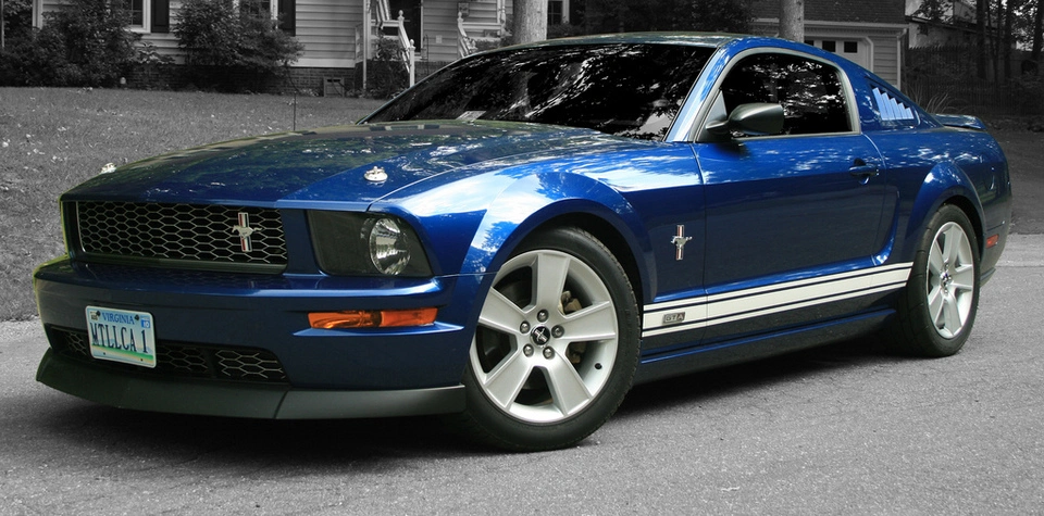

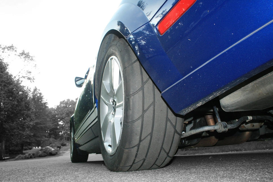

I have the 265/40-18 MT ET Streets on the 8.5" Fanblade and the fit is really good. I don't know if it would be practical to mount it on the 9.5" wheel??? I don't believe Nitto DRs are great for track duty. Their harder compound allows them to provide very good dry traction on the street and last longer than most other DRs. 20" wheels and DRs shouldn't be used in the same sentence. IMO, it's mostly about the look. Sure they will have a sticky tread, but there isn't much sidewall to flex and help launch the car. Of your choices, the 305/45-18 on the 9.5" wheel looks best.
Here are some pics of my track duty shoes...
