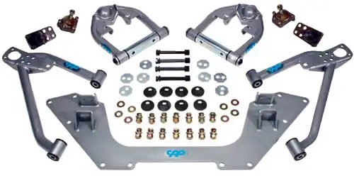

I have the CPP front suspension in the car. I love the way it handles, but I do not love the way my steering is. Sloppy and lots of give.

First of all can you add a power rack and pinion to a mustang that has the CPP front suspension on it? Like a Randals Rack?

Also you can use R&P with this setup I'm sure as it takes up the same space as the old setup just hangs a bit lower.
