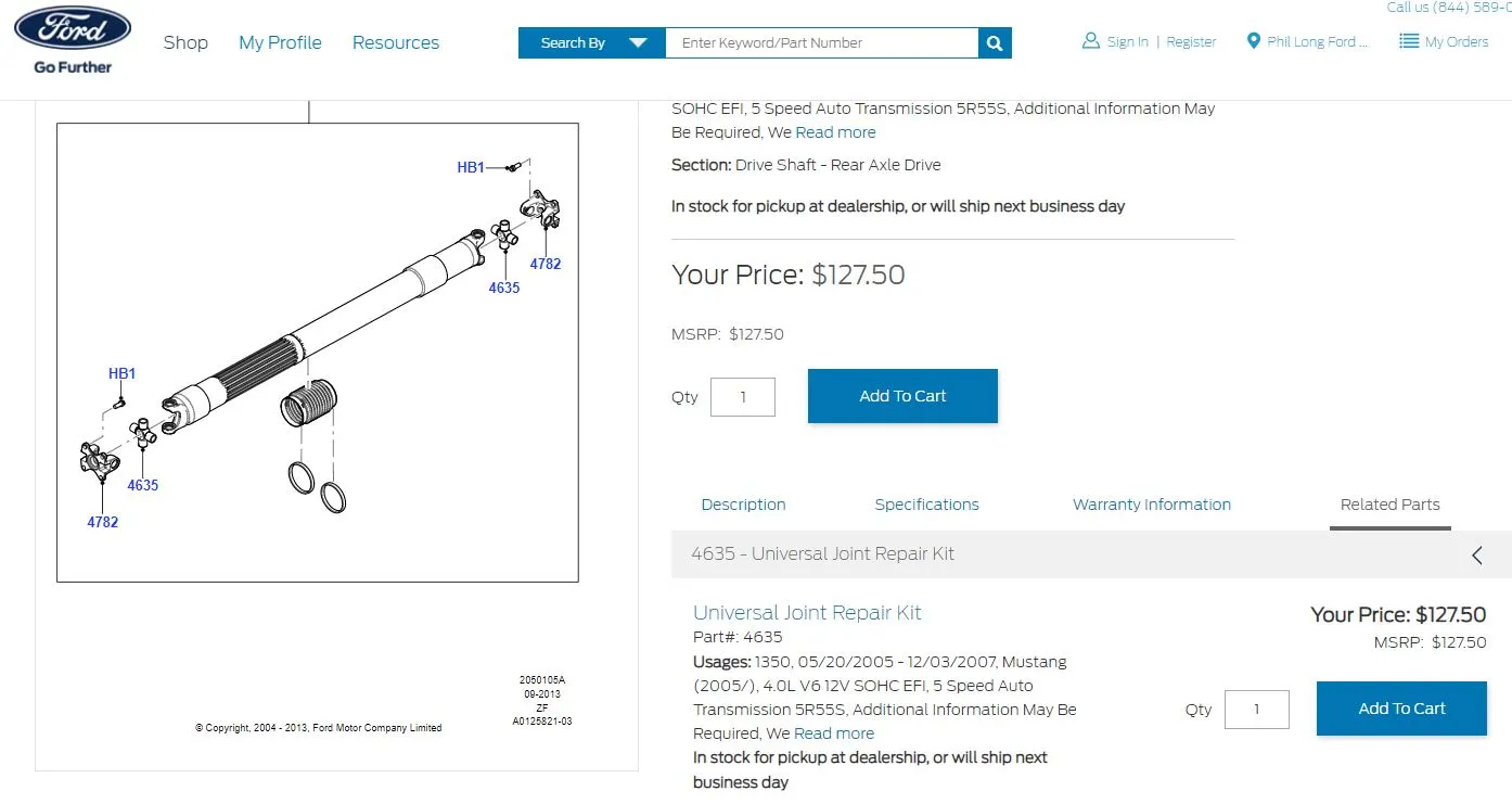

For anyone that may be curious in the future, I came across this on a local Ford Dealerships service dept page. Part 4635 is labeled as a 1350. I ordered a Yukon 1350 with Zerk Fitting on Amazon. I'll update if this works if anyones looking in the future. It's been a bit of a hassle finding a definite answer.
