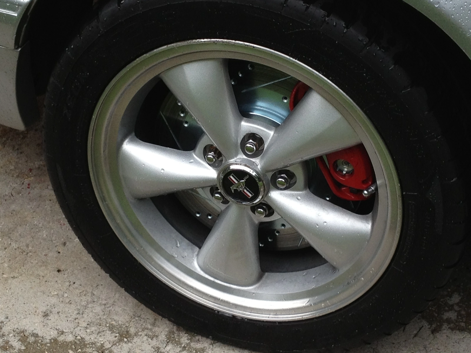

They are 02-03 Bullit wheels. 17X8"
I think the S197's were only available in 17X9" but I could be wrong on that.
Those are 05+ Bullitts. 17x8.
The offsets is a little deep on them, so they may look sunken in and you might get rub on the A-arm when turning up front. Guys usually spacers with these, or use the 01-04 bullitt for a better fit
