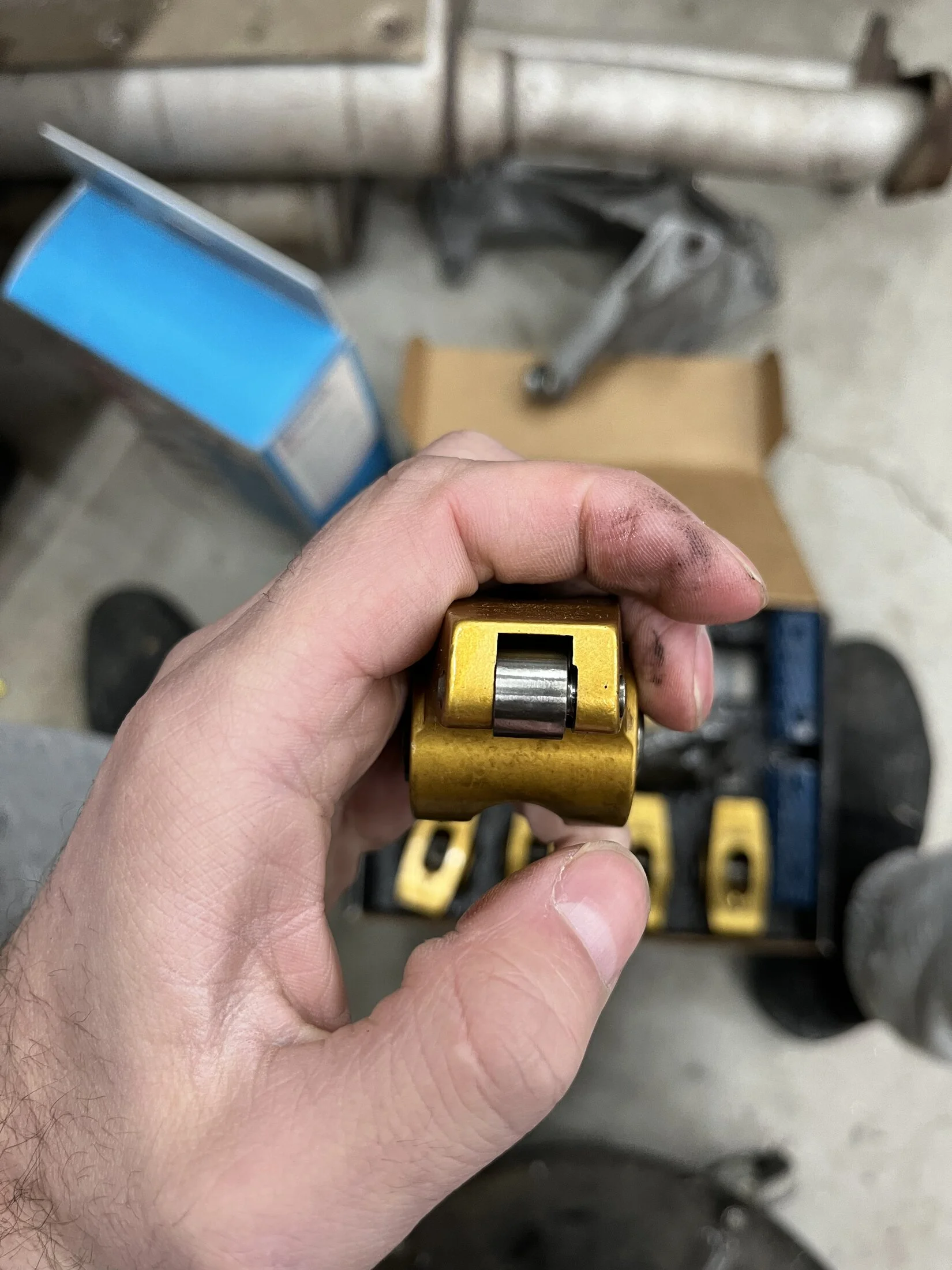

What would cause this rocker arm damage?

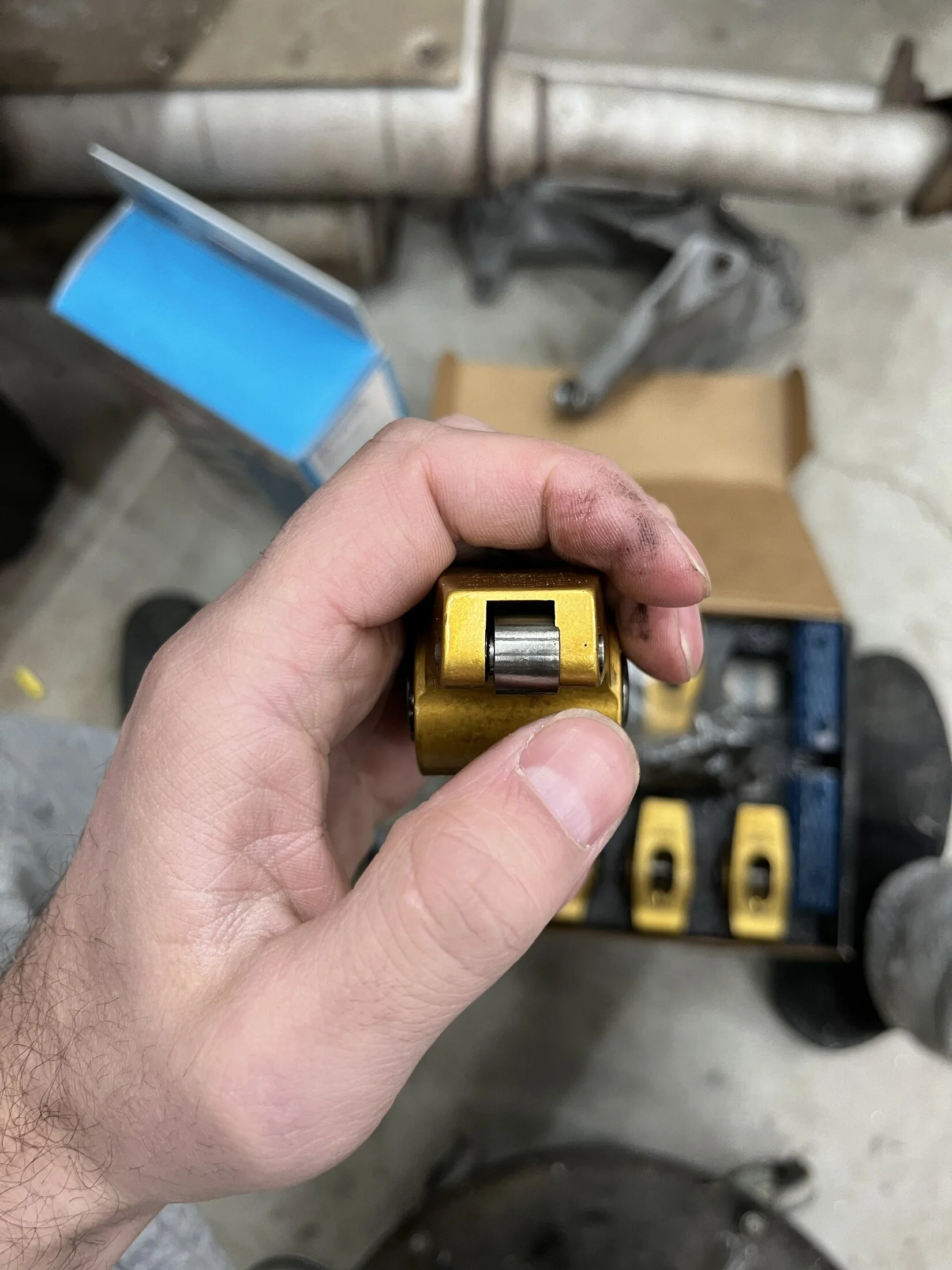

I have a set of crane golds that I took off my car. I didn’t set these up, they were on the car and adjusted when I bought it. A few years ago I was in the engine, saw the damage and replaced them. Yesterday I was cleaning the garage and came across them. It has me wondering, what would cause this damage? And are they junk?

Possibly the rocker stud is bent or crooked or valve stem.
I should’ve mentioned they are pedestal mount.
Something can still be out of alignment on that rocker/valve. Throw a good one on and rotate the engine and see if it walks the roller over to that same side. Hit the top of the valve with a sharpie and see how the contact patch looks. You sure those are designed to be pedestal mount?

Yea they are pedestal mount. I did end up putting some other rockers arms on. At the time I shimmed them correctly, having a good contact patch, preload, etc. There were actually quite a few like this, though I can’t remember how many off the top of my head. Maybe the previous owner set the lash wrong?

Those aluminum rocker arms simply wear out
Crane are some of the better ones IMO

https://www.corral.net/threads/roller-eating-into-side-of-rocker-arm-source-of-clacking.572902/
Kato knows his stuff.
