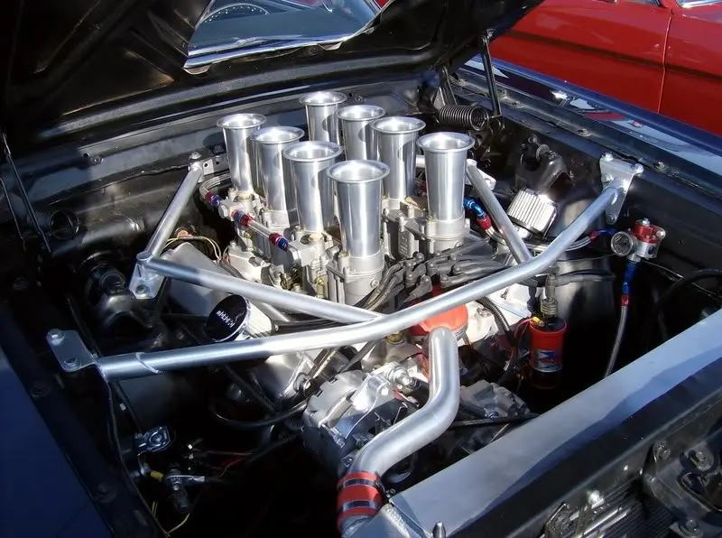

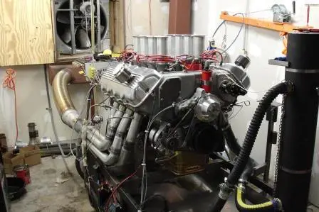

I agree to a point, but if you really, really want "wow factor," how about four downdraft Webers?
Or maybe eight stacks of Hilborn injection?
On a cammer.
