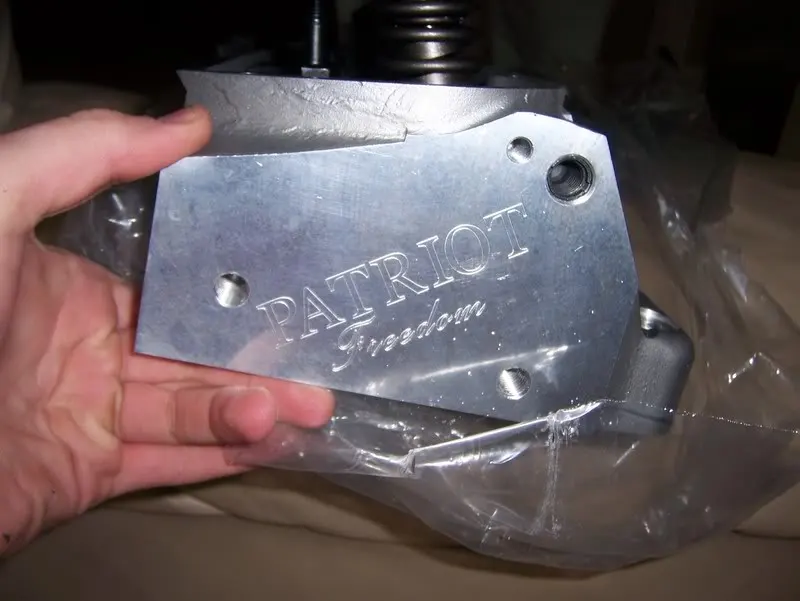

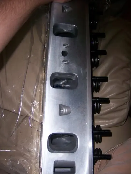

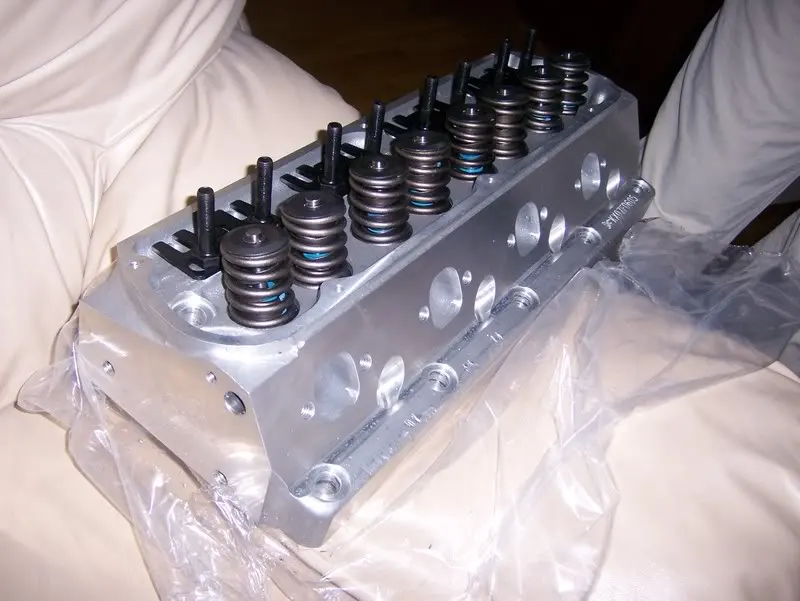

I checked the port alignment on my heads and had them checked out off the car by a damn reputable shop in my area. Like I said the only thing I had to swap was the guide plates and they were 22 dollars new. Here are my initial pics. Good heads for the money, if you need bigger, go bigger.
