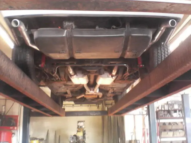

whats a good set i should buy? within a resonable price? my pasenger side blew out today and needs replaced...so..what gaskets to go with?
went and got tail pipes put on becasue the drone was just to much for me lol...dont hate...40 bucks for mufflers back welded on...ill take it and put a nice set of tips on in spring.
I've always used the paper Mr. Gasket ones with zero problems. Just check your bolts after every couple times you drive it after you install them and then just check them when you change your oil.(should stay tight though)
If you want a bit of security, you could use the paper gaskets with a thin layer of Copper RTV. Most will say to run the RTV by itsself with no gasket, but ive not done this since ive had great luck with the paper gaskets.(knocks on wood)
