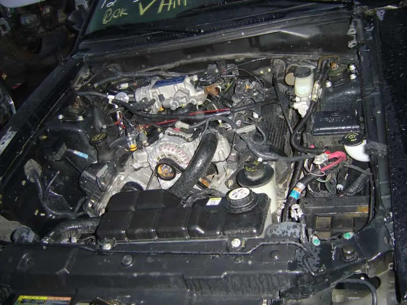

from the attached image, what's missing? i got this car from an insurance auto auction for 9 thousand and a lot, if not all of the essential bolt-ons are missing, i was just wondering if you modular motor kings could lend a helping hand in telling me what's been stolen off my car. thanks it's a 2002 gt with 12000 miles on it

thanks, can you give a detailed list of what you can see, and a place online where i can order the missing parts from? im no good at this stuff, im a newbie, i think it's a maf sensor? mass air plug, battery, cold air intake, and some tube that goes to my intake? not sure. thanks
please excuse my ignorance, but can someone please post a detailed list of parts so i can order them? and a place online i can actually find all the plugs and wiring harnesses i'll need? thanks
like this black thing with the wiring harness coming out of it? and the tube coming off the intake?

battery
Upper intake tube
MAF
Air filter
Air box
Air box silencer
Vacuum lines coming off the IAC
Not sure why your Plenum says Steeda on it. May be just a sticker.
Looks to be low on fluid
On the passenger side, I hope that isnt a cut wire I see. That is your air temp wire I think.
http://www.stangparts.com/
